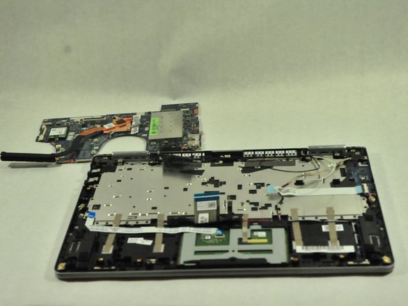

  8. Lenovo Yoga 710-14IKB Motherboard Replacement, Motherboard: crwdns2935265:08crwdnd2935265:01crwdnd2935265:01crwdne2935265:0
    • Use a PH00 screwdriver to remove the nine 3mm screws.
  9. Lenovo Yoga 710-14IKB Motherboard Replacement: crwdns2935265:09crwdnd2935265:01crwdnd2935265:02crwdne2935265:0 Lenovo Yoga 710-14IKB Motherboard Replacement: crwdns2935265:09crwdnd2935265:02crwdnd2935265:02crwdne2935265:0
    • Disconnect the indicated cables from the motherboard.
    • Be careful when removing cables. Do not pull or yank cables from their slots.
    • Remove the motherboard.
    • If you want to fully remove the motherboard, you must desolder the display cable.
