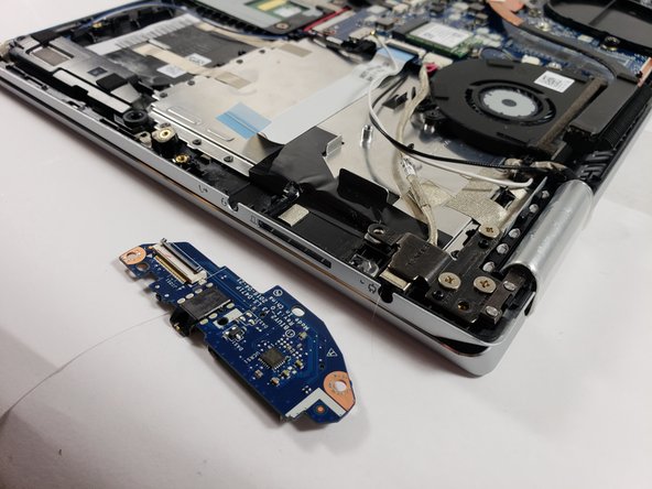

  6. Lenovo Yoga 710-14IKB Headphone Jack Replacement, Headphone Jack: crwdns2935265:06crwdnd2935265:01crwdnd2935265:01crwdne2935265:0
    • Remove the two 3mm screws from the headphone jack using a PH00 screwdriver.
    • Make sure not to strip the screws as they can sometimes be hard to remove.
  7. Lenovo Yoga 710-14IKB Headphone Jack Replacement: crwdns2935265:07crwdnd2935265:01crwdnd2935265:01crwdne2935265:0
    • Pop the black bar on the tip of the wire connected to the headphone jack circuitboard.
    • Disconnect the wire.
    • Be careful not to pull or yank the cable.
  8. Lenovo Yoga 710-14IKB Headphone Jack Replacement: crwdns2935265:08crwdnd2935265:01crwdnd2935265:02crwdne2935265:0 Lenovo Yoga 710-14IKB Headphone Jack Replacement: crwdns2935265:08crwdnd2935265:02crwdnd2935265:02crwdne2935265:0
    • Remove the headphone jack circuitboard.
