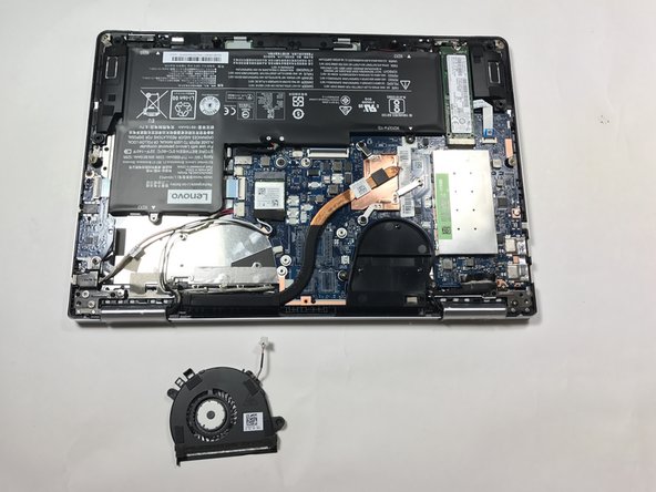

    • Ensure your device is completely OFF before starting this guide.
    • Use a Torx T4 screwdriver to unscrew the nine 5 mm screws holding the cover in place.
    • Use a Torx T4 screwdriver to unscrew the 8 mm screw in the center.
    • When, reassembling, make sure not to tighten the screws too much or you may risk cracking the plastic cover.
  2. Lenovo Yoga 710-14IKB Fan Replacement: crwdns2935265:02crwdnd2935265:01crwdnd2935265:03crwdne2935265:0 Lenovo Yoga 710-14IKB Fan Replacement: crwdns2935265:02crwdnd2935265:02crwdnd2935265:03crwdne2935265:0 Lenovo Yoga 710-14IKB Fan Replacement: crwdns2935265:02crwdnd2935265:03crwdnd2935265:03crwdne2935265:0
    • Use the plastic opening tool to pry the cover up and away from the laptop, starting at one end and working your way around the cover.
    • The cover is large and flat and made of thin plastic. It cracks easily, so make sure not to pry too hard.
  3. Lenovo Yoga 710-14IKB Fan Replacement, Fan: crwdns2935265:03crwdnd2935265:01crwdnd2935265:02crwdne2935265:0 Lenovo Yoga 710-14IKB Fan Replacement, Fan: crwdns2935265:03crwdnd2935265:02crwdnd2935265:02crwdne2935265:0
    • Unscrew the the two 4mm Phillips #00 screws holding the fan in place.
    • Be careful not to break the thin plastic tabs on the fan casing.
  4. Lenovo Yoga 710-14IKB Fan Replacement: crwdns2935265:04crwdnd2935265:01crwdnd2935265:02crwdne2935265:0 Lenovo Yoga 710-14IKB Fan Replacement: crwdns2935265:04crwdnd2935265:02crwdnd2935265:02crwdne2935265:0
    • Use your fingernail or a plastic tool to disconnect the fan power cable from the circuit board.
    • Slide it straight out of its socket.
  5. Lenovo Yoga 710-14IKB Fan Replacement: crwdns2935265:05crwdnd2935265:01crwdnd2935265:02crwdne2935265:0 Lenovo Yoga 710-14IKB Fan Replacement: crwdns2935265:05crwdnd2935265:02crwdnd2935265:02crwdne2935265:0
    • Lift the fan up and out of its mount.
    • Be careful that the small plastic tabs don't get snagged on any other parts or cables.
