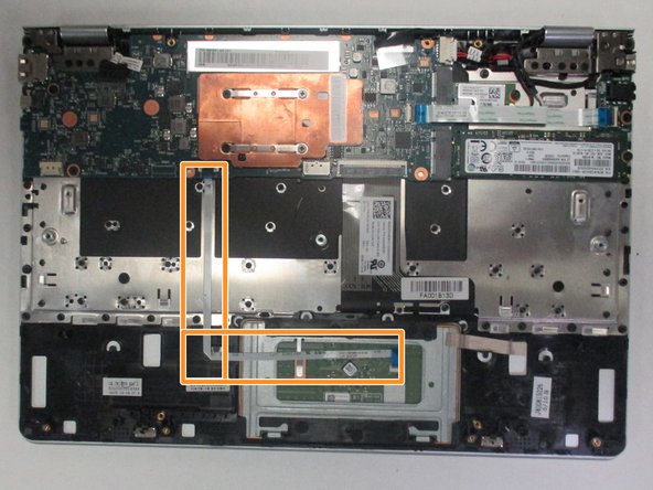

    • Remove the 11 screws located on the back panel using a T5 Torx screwdriver.
  2. Lenovo Yoga 710-11ISK Speaker Replacement: crwdns2935265:02crwdnd2935265:01crwdnd2935265:01crwdne2935265:0
    • Insert an opening tool between the bottom panel and chassis, then pry around the entire perimeter until the five clips detach, releasing the bottom panel.

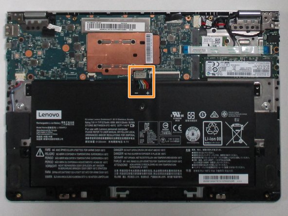

    • Use a Phillips #000 screwdriver to remove the four screws securing the battery.
    • Grip the battery cable connector on both sides of the plug and gently pull it directly from its port.
    • Lift the battery up and out.

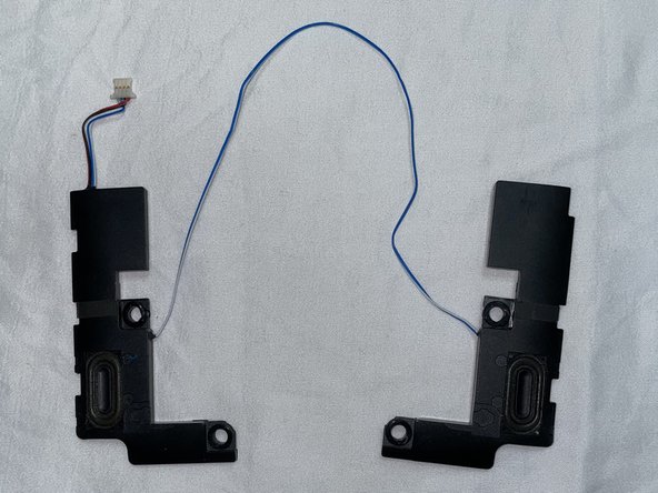

    • Unplug the wire harness on the left side of the computer to disconnect the speakers from the motherboard
    • Remove the white and blue wires from the plastic brackets holding them in place.
  5. Lenovo Yoga 710-11ISK Speaker Replacement: crwdns2935265:05crwdnd2935265:01crwdnd2935265:03crwdne2935265:0 Lenovo Yoga 710-11ISK Speaker Replacement: crwdns2935265:05crwdnd2935265:02crwdnd2935265:03crwdne2935265:0 Lenovo Yoga 710-11ISK Speaker Replacement: crwdns2935265:05crwdnd2935265:03crwdnd2935265:03crwdne2935265:0
    • Carefully remove both speakers and rubber grommets from their mounts.
    • Slide the right speaker underneath the white ribbon wire.
    • Lift the speakers up and out.
