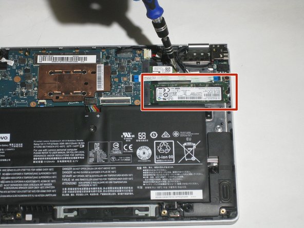

  3. Lenovo Yoga 710-11ISK SSD Replacement, SSD: crwdns2935265:03crwdnd2935265:01crwdnd2935265:02crwdne2935265:0 Lenovo Yoga 710-11ISK SSD Replacement, SSD: crwdns2935265:03crwdnd2935265:02crwdnd2935265:02crwdne2935265:0
    • Use a Phillips #00 screwdriver to remove the single 3 mm screw on the right of the SSD.
  4. Lenovo Yoga 710-11ISK SSD Replacement: crwdns2935265:04crwdnd2935265:01crwdnd2935265:01crwdne2935265:0
    • Disconnect and pull the SSD out of the motherboard.
