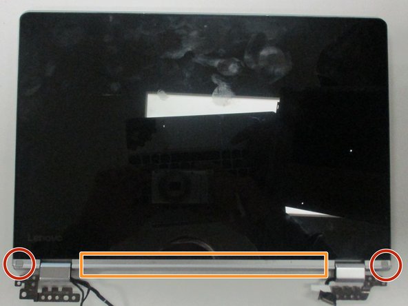

    • Remove the screw covers located near the hinges on the display side using an opening tool.
    • Remove the cover panel between the screw covers using an opening tool.

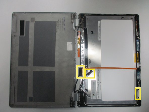

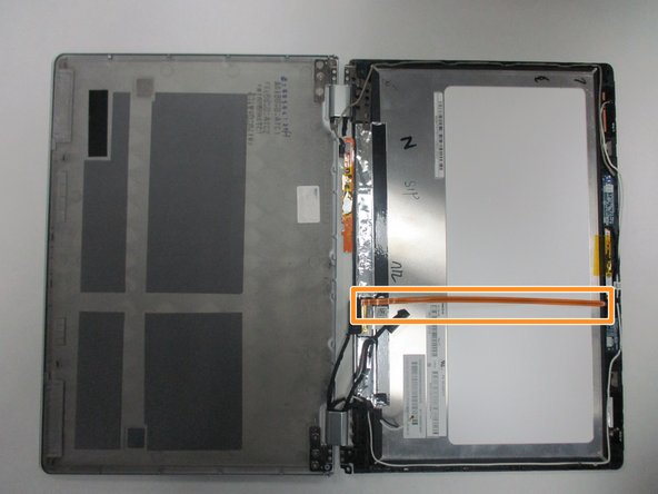

  6. Lenovo Yoga 710-11ISK Hinge Replacement: crwdns2935265:06crwdnd2935265:01crwdnd2935265:03crwdne2935265:0 Lenovo Yoga 710-11ISK Hinge Replacement: crwdns2935265:06crwdnd2935265:02crwdnd2935265:03crwdne2935265:0 Lenovo Yoga 710-11ISK Hinge Replacement: crwdns2935265:06crwdnd2935265:03crwdnd2935265:03crwdne2935265:0
    • Disconnect the black and white wires from the sides of the display.
    • Disconnect the orange ribbon cable.

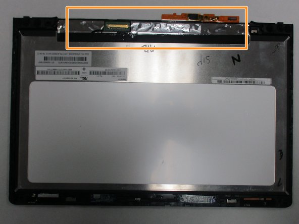

    • Remove the tape, covers, and stickers that hold in the components.

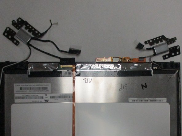

  7. Lenovo Yoga 710-11ISK Hinge Replacement: crwdns2935265:07crwdnd2935265:01crwdnd2935265:02crwdne2935265:0 Lenovo Yoga 710-11ISK Hinge Replacement: crwdns2935265:07crwdnd2935265:02crwdnd2935265:02crwdne2935265:0
    • Soldering/desoldering presents potential for device damage and burns. Always solder/desolder in a well-ventilated environment.
    • Use a soldering iron to disconnect the ends of both wires that are embedded into the display.
    • Remove the hinges and their components from the computer.
