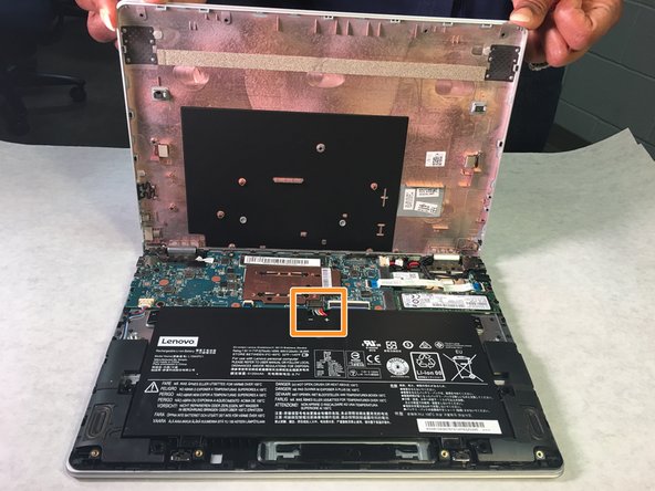

  2. Lenovo Yoga 710-11ISK Battery Replacement, Removing back cover: crwdns2935265:02crwdnd2935265:01crwdnd2935265:01crwdne2935265:0
    • Remove the back panel carefully.
    • To remove the back cover, there are 5 plastic snap hooks that must be dislodged with a spudger or plastic pick tool.
    • Lay the device upside down with hinges away from you. Tilt it at 45 degree angle, leaving hinges down and open the screen slightly. Apply a little pressure on one corner to see where it separates. Then work from side to side to separate the back case from the top case. The back case is a shell with no components in it.
  3. Lenovo Yoga 710-11ISK Battery Replacement: crwdns2935265:03crwdnd2935265:01crwdnd2935265:02crwdne2935265:0 Lenovo Yoga 710-11ISK Battery Replacement: crwdns2935265:03crwdnd2935265:02crwdnd2935265:02crwdne2935265:0
    • Remove the two 3mm Phillips #1 screws that are holding the battery to the device.
    • Hold the bundled cable connector on each side and carefully pull the connector to release it from the motherboard.
  4. Lenovo Yoga 710-11ISK Battery Replacement: crwdns2935265:04crwdnd2935265:01crwdnd2935265:01crwdne2935265:0
    • Remove the battery carefully from the device by lifting up the edge nearest you and then gently pull toward you to disconnect the power wires.
