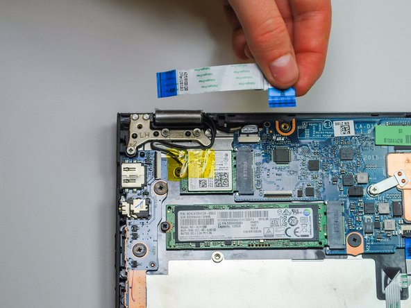

  5. Lenovo Yoga 700-11ISK Wireless Card Replacement, Wireless Card: crwdns2935265:05crwdnd2935265:01crwdnd2935265:03crwdne2935265:0 Lenovo Yoga 700-11ISK Wireless Card Replacement, Wireless Card: crwdns2935265:05crwdnd2935265:02crwdnd2935265:03crwdne2935265:0 Lenovo Yoga 700-11ISK Wireless Card Replacement, Wireless Card: crwdns2935265:05crwdnd2935265:03crwdnd2935265:03crwdne2935265:0
    • Place the laptop with the LCD facing down so that the hinges face opposite you.
    • Disconnect both ends of the two blue ZIF (zero insertion force) connectors in the upper left corner and by gently flipping the black tabs on the connector and pulling up and away from both ends of the connectors.
    • Do not pull on the blue tab of the cable without lifting up the black tabs on the connectors. The cable should slide in and out effortlessly. If there is resistance when pulling the cable, double check the black tabs.
  6. Lenovo Yoga 700-11ISK Wireless Card Replacement: crwdns2935265:06crwdnd2935265:01crwdnd2935265:01crwdne2935265:0
    • Unplug the black and white wireless LAN cables in the upper left corner by gently pulling upwards.
    • To reinstall a wireless LAN card, note that the black cable goes to the MAIN jack, and the white to the AUX jack.

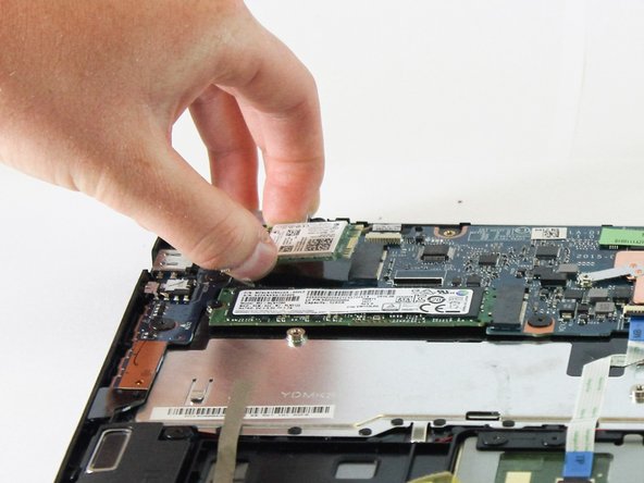

  7. Lenovo Yoga 700-11ISK Wireless Card Replacement: crwdns2935265:07crwdnd2935265:01crwdnd2935265:02crwdne2935265:0 Lenovo Yoga 700-11ISK Wireless Card Replacement: crwdns2935265:07crwdnd2935265:02crwdnd2935265:02crwdne2935265:0
    • Remove the one 2mm Phillips #1 screw.
    • Remove the card by pulling to the left and up.
