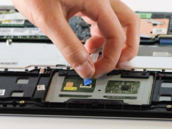

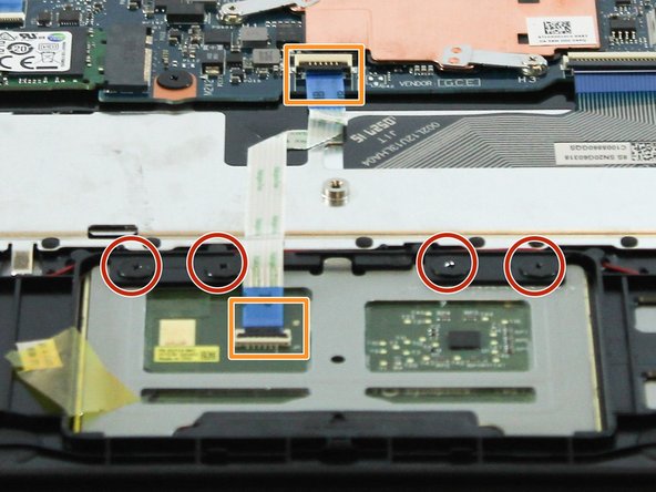

    • Remove the four 4mm Phillips #1 screws holding the touchpad onto the laptop.
    • Use a spudger to lift up the two black tabs on the ZIF connectors and then pull the cable out by the blue tab.
    • The cable should slide in and out effortlessly. If there is resistance when pulling the cable, double check the black tabs.
  6. Lenovo Yoga 700-11ISK Touchpad Replacement: crwdns2935265:06crwdnd2935265:01crwdnd2935265:01crwdne2935265:0
    • Slightly separate the two halves of the laptop with one hand and slide the touchpad out from the laptop with the other.
    • There may be silver tape holding the touchpad to the laptop. You do not need to replace the tape when reassembling the device.

The “Tools Required” section says “Torx T7” but Step 1 lists, and (more importantly) the actual device has Torx T5 screws.
Step 5 suggests using a spudger, so perhaps that should be listed too.
