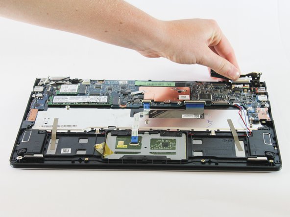

    • Remove the following screws holding both the right LCD hinge and the power port to the laptop:
    • Four 5mm Phillips #1 screws.
    • One 3mm Phillips #1 screw.
    • Gently pull the hinge up and away from the laptop.

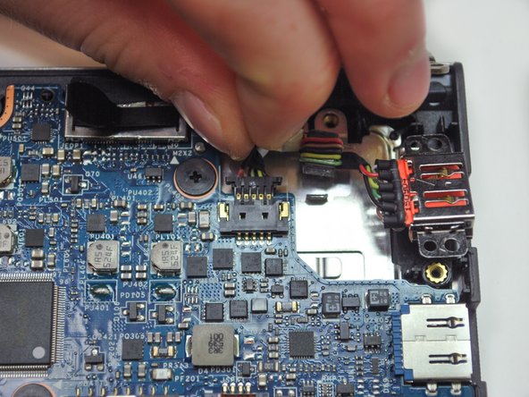

  6. Lenovo Yoga 700-11ISK Power Port Replacement: crwdns2935265:06crwdnd2935265:01crwdnd2935265:03crwdne2935265:0 Lenovo Yoga 700-11ISK Power Port Replacement: crwdns2935265:06crwdnd2935265:02crwdnd2935265:03crwdne2935265:0 Lenovo Yoga 700-11ISK Power Port Replacement: crwdns2935265:06crwdnd2935265:03crwdnd2935265:03crwdne2935265:0
    • Carefully slide bundle cable connector out from its connector on the motherboard.
    • Pull the ends of the black connector containing the wires to avoid damage to the wires.
