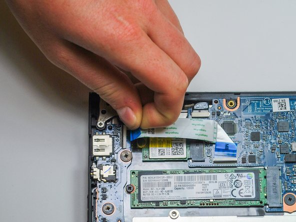

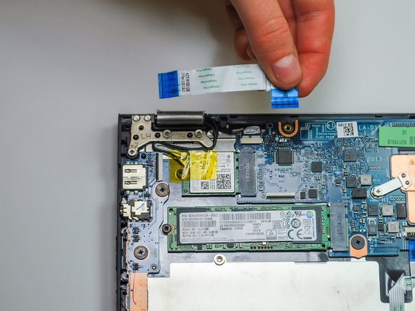

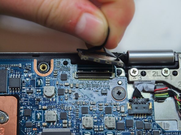

    • Disconnect the following cables attaching the LCD to the laptop:
    • Touchscreen cable
    • EDP cable
  6. Lenovo Yoga 700-11ISK LCD Replacement: crwdns2935265:06crwdnd2935265:01crwdnd2935265:03crwdne2935265:0 Lenovo Yoga 700-11ISK LCD Replacement: crwdns2935265:06crwdnd2935265:02crwdnd2935265:03crwdne2935265:0 Lenovo Yoga 700-11ISK LCD Replacement: crwdns2935265:06crwdnd2935265:03crwdnd2935265:03crwdne2935265:0

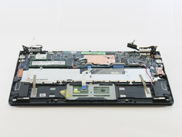

    • Place the laptop with the LCD facing down so that the hinges face opposite you.
    • Disconnect both ends of the two blue ZIF (zero insertion force) connectors in the upper left corner by gently flipping the black tabs on the connector and pulling up and away from both ends of the connectors.
    • Do not pull on the blue tab of the cable without lifting up the black tabs on the connectors. The cable should slide in and out effortlessly. If there is resistance when pulling the cable, double check the black tabs.

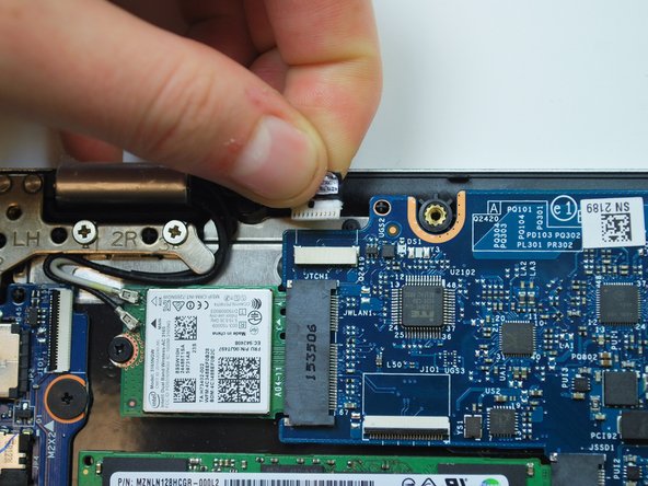

  7. Lenovo Yoga 700-11ISK LCD Replacement: crwdns2935265:07crwdnd2935265:01crwdnd2935265:01crwdne2935265:0
    • Unplug the black and white wireless LAN cables in the upper left corner by gently pulling upwards.
    • To reinstall a wireless LAN card, note that the black cable goes to the MAIN jack, and the white to the AUX jack.

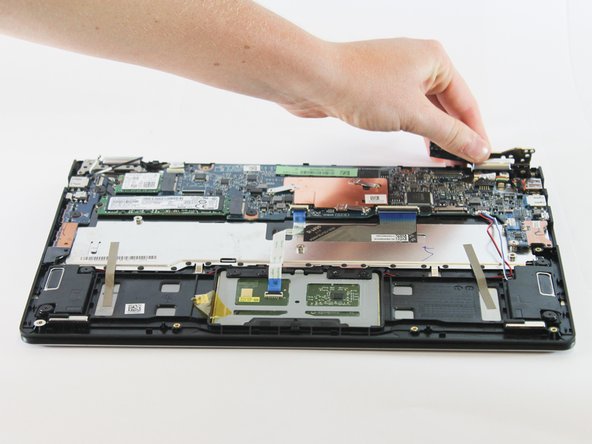

    • Remove the base from the LCD by lifting it upwards.
    • Flip the LCD so that the hinges face you and the screen faces upwards.

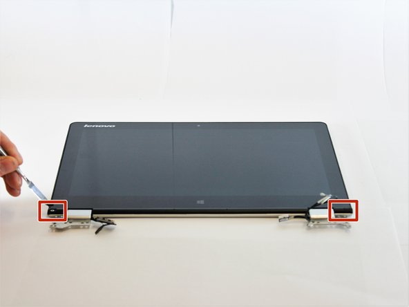

    • Remove the two LCD bezel screw pads located in the bottom left and right outer corners by pulling them up and out.
    • Remove the two 4.4 mm Phillips #1 screws located under the screw pads.

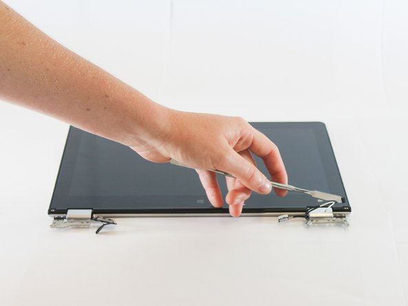

    • Pry the two side hinge covers with a plastic spudger and pull them up and away from the LCD.

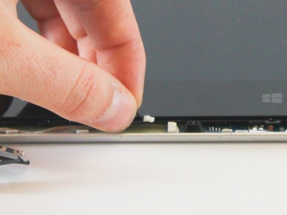

    • Disconnect the white MIC board connecter located near the center of the LCD bezel by pulling it out to the left.
    • Flip the hinges up and remove the hinge rubbers by pulling the wires out and away from the hinges.
