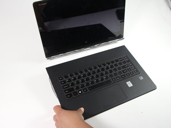

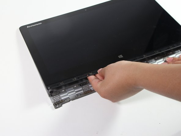

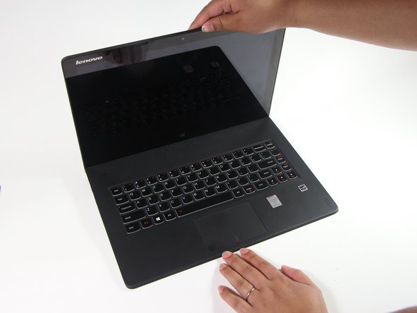

    • Flip over the laptop so that it's facing up
    • Gently open the laptop to separate the screen from the laptop chassis.

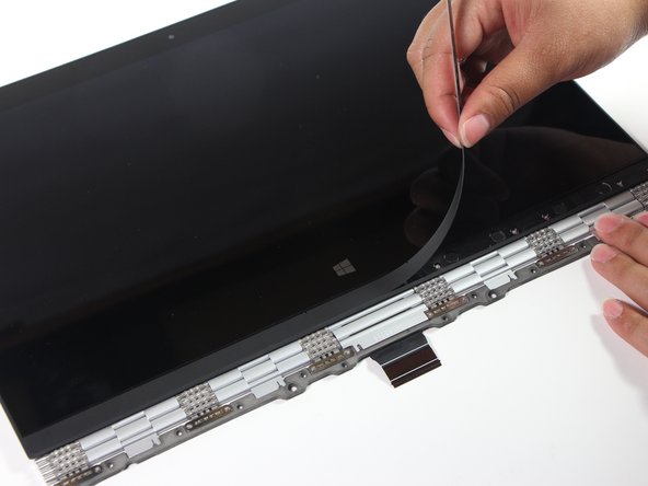

  22. Lenovo Yoga 3 Pro Screen Replacement: crwdns2935265:022crwdnd2935265:01crwdnd2935265:02crwdne2935265:0 Lenovo Yoga 3 Pro Screen Replacement: crwdns2935265:022crwdnd2935265:02crwdnd2935265:02crwdne2935265:0
    • The screw cover is held down with adhesive and is very fragile.
    • Remove the black screw cover from the screen by prying with the wide plastic opening tool.
    • Pull it off slowly.

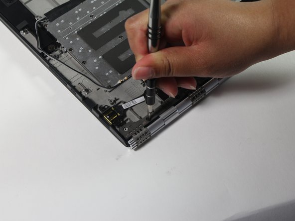

  23. Lenovo Yoga 3 Pro Screen Replacement: crwdns2935265:023crwdnd2935265:01crwdnd2935265:01crwdne2935265:0
    • Remove the eight #0 2.4mm Phillips screws holding down the monitor.

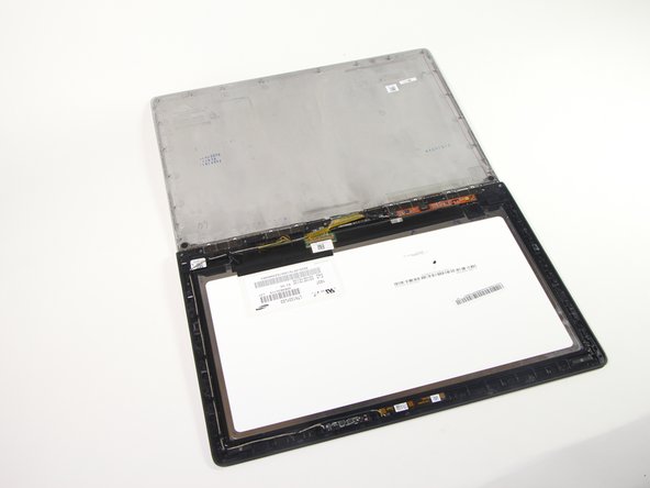

  25. Lenovo Yoga 3 Pro Screen Replacement: crwdns2935265:025crwdnd2935265:01crwdnd2935265:01crwdne2935265:0
    • Slowly go around the perimeter of the screen with your fingers to loosen all the tabs holding down the monitor.
  26. Lenovo Yoga 3 Pro Screen Replacement: crwdns2935265:026crwdnd2935265:01crwdnd2935265:02crwdne2935265:0 Lenovo Yoga 3 Pro Screen Replacement: crwdns2935265:026crwdnd2935265:02crwdnd2935265:02crwdne2935265:0
    • Be careful with the ribbon cable.
    • With the screen facing up, flip the screen assembly over

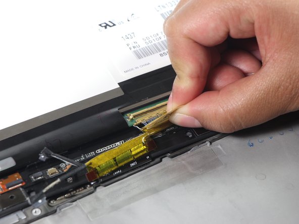

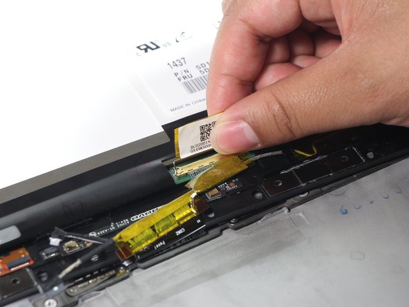

  28. Lenovo Yoga 3 Pro Screen Replacement: crwdns2935265:028crwdnd2935265:01crwdnd2935265:03crwdne2935265:0 Lenovo Yoga 3 Pro Screen Replacement: crwdns2935265:028crwdnd2935265:02crwdnd2935265:03crwdne2935265:0 Lenovo Yoga 3 Pro Screen Replacement: crwdns2935265:028crwdnd2935265:03crwdnd2935265:03crwdne2935265:0
    • Remove the flat flex cable by first lifting the hinge then pulling the hinge away from the connector.
    • The hinge may be taped down, so lift the tape and pull the hinge via the tape.

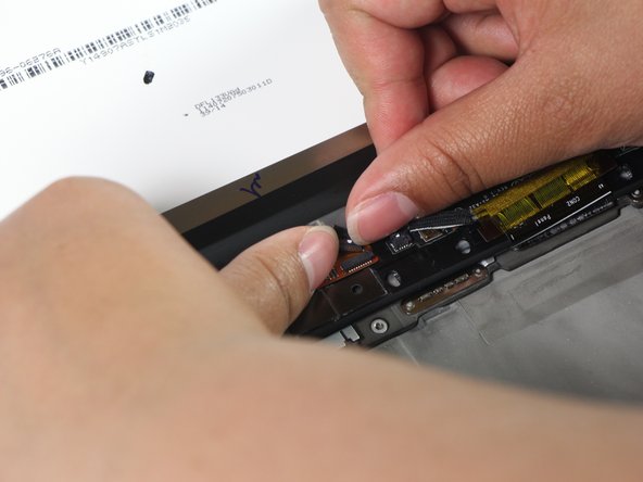

  29. Lenovo Yoga 3 Pro Screen Replacement: crwdns2935265:029crwdnd2935265:01crwdnd2935265:01crwdne2935265:0

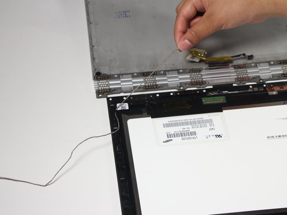

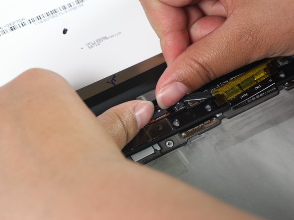

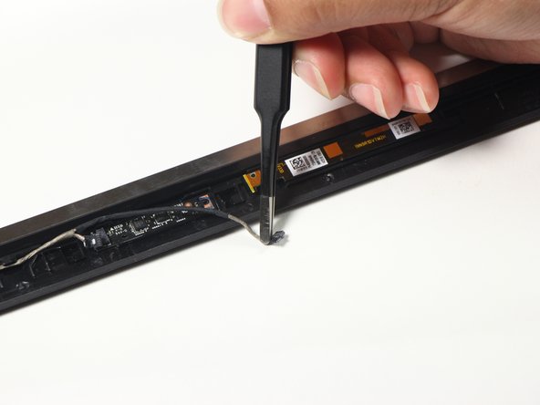

    • Peel off the tape holding down the webcam cable.
  30. Lenovo Yoga 3 Pro Screen Replacement: crwdns2935265:030crwdnd2935265:01crwdnd2935265:03crwdne2935265:0 Lenovo Yoga 3 Pro Screen Replacement: crwdns2935265:030crwdnd2935265:02crwdnd2935265:03crwdne2935265:0 Lenovo Yoga 3 Pro Screen Replacement: crwdns2935265:030crwdnd2935265:03crwdnd2935265:03crwdne2935265:0

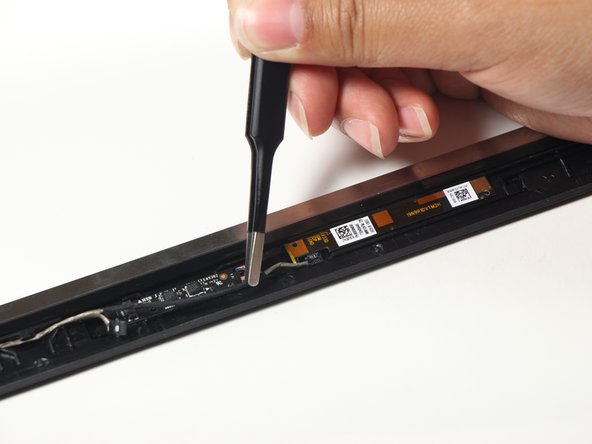

    • Disconnect the two cables connecting the webcam.
    • It may be easier to remove the webcam connector with tweezers.
  31. Lenovo Yoga 3 Pro Screen Replacement: crwdns2935265:031crwdnd2935265:01crwdnd2935265:02crwdne2935265:0 Lenovo Yoga 3 Pro Screen Replacement: crwdns2935265:031crwdnd2935265:02crwdnd2935265:02crwdne2935265:0
    • Carefully unroute the webcam connector from the plastic tabs holding it down.
