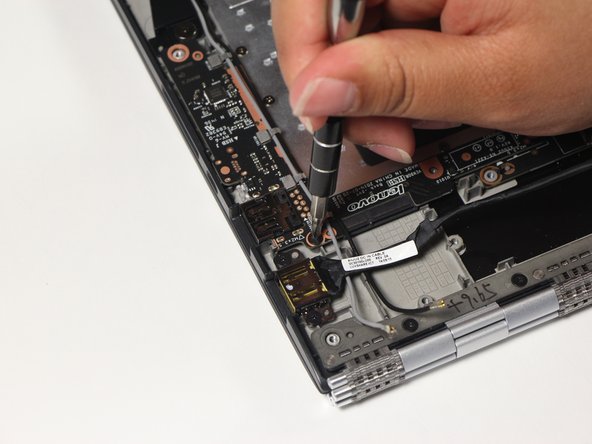

  12. Lenovo Yoga 3 Pro Motherboard Replacement: crwdns2935265:012crwdnd2935265:01crwdnd2935265:03crwdne2935265:0 Lenovo Yoga 3 Pro Motherboard Replacement: crwdns2935265:012crwdnd2935265:02crwdnd2935265:03crwdne2935265:0 Lenovo Yoga 3 Pro Motherboard Replacement: crwdns2935265:012crwdnd2935265:03crwdnd2935265:03crwdne2935265:0
    • Remove the two #0 2.9mm Phillips screws from the daughter board.

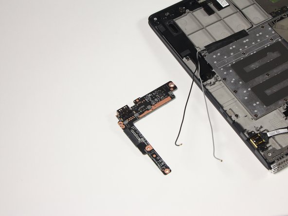

  13. Lenovo Yoga 3 Pro Motherboard Replacement: crwdns2935265:013crwdnd2935265:01crwdnd2935265:01crwdne2935265:0
    • Lift the daughter board with the plastic opening tool.
    • You will hear two clicks when lifting the daughter board.
  14. Lenovo Yoga 3 Pro Motherboard Replacement: crwdns2935265:014crwdnd2935265:01crwdnd2935265:03crwdne2935265:0 Lenovo Yoga 3 Pro Motherboard Replacement: crwdns2935265:014crwdnd2935265:02crwdnd2935265:03crwdne2935265:0 Lenovo Yoga 3 Pro Motherboard Replacement: crwdns2935265:014crwdnd2935265:03crwdnd2935265:03crwdne2935265:0
    • Lift the daughter board, unrouting the wireless cables from their plastic holders, and place it to the side.

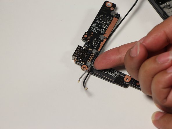

  15. Lenovo Yoga 3 Pro Motherboard Replacement: crwdns2935265:015crwdnd2935265:01crwdnd2935265:03crwdne2935265:0 Lenovo Yoga 3 Pro Motherboard Replacement: crwdns2935265:015crwdnd2935265:02crwdnd2935265:03crwdne2935265:0 Lenovo Yoga 3 Pro Motherboard Replacement: crwdns2935265:015crwdnd2935265:03crwdnd2935265:03crwdne2935265:0
    • Gently lift the metal tabs on the daughter board to free the wires.

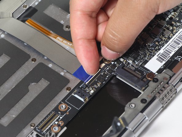

  16. Lenovo Yoga 3 Pro Motherboard Replacement: crwdns2935265:016crwdnd2935265:01crwdnd2935265:03crwdne2935265:0 Lenovo Yoga 3 Pro Motherboard Replacement: crwdns2935265:016crwdnd2935265:02crwdnd2935265:03crwdne2935265:0 Lenovo Yoga 3 Pro Motherboard Replacement: crwdns2935265:016crwdnd2935265:03crwdnd2935265:03crwdne2935265:0

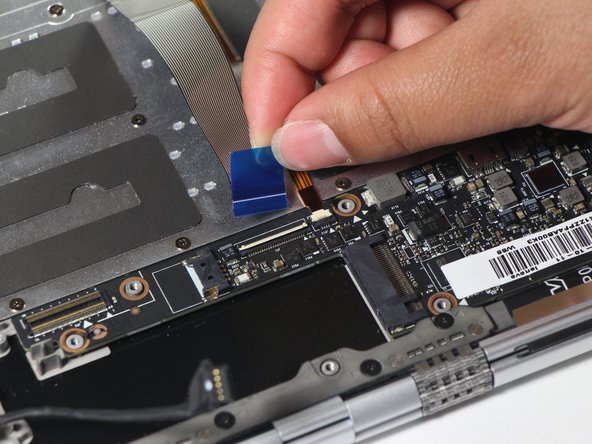

    • Detach the five flat flex cables attached to the motherboard as follows:
    • 1. Flip the cable holder up with a finger nail
    • 2. Pull on the tab to remove the cable.
    • The large black flat flex labeled 'MB' does not have a tab so gently tug the cable free from the end after flipping the cable holder.

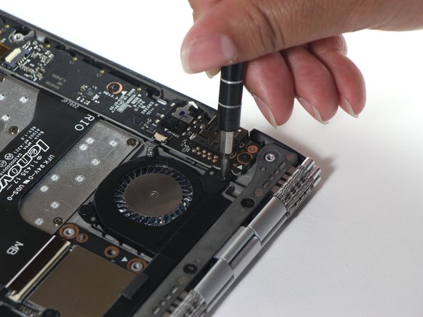

  17. Lenovo Yoga 3 Pro Motherboard Replacement: crwdns2935265:017crwdnd2935265:01crwdnd2935265:03crwdne2935265:0 Lenovo Yoga 3 Pro Motherboard Replacement: crwdns2935265:017crwdnd2935265:02crwdnd2935265:03crwdne2935265:0 Lenovo Yoga 3 Pro Motherboard Replacement: crwdns2935265:017crwdnd2935265:03crwdnd2935265:03crwdne2935265:0
    • Remove the four #0 2.3mm Phillips screws holding down the motherboard.
    • Remove the two #0 2.9mm Phillips screws holding down the fan.
  18. Lenovo Yoga 3 Pro Motherboard Replacement: crwdns2935265:018crwdnd2935265:01crwdnd2935265:03crwdne2935265:0 Lenovo Yoga 3 Pro Motherboard Replacement: crwdns2935265:018crwdnd2935265:02crwdnd2935265:03crwdne2935265:0 Lenovo Yoga 3 Pro Motherboard Replacement: crwdns2935265:018crwdnd2935265:03crwdnd2935265:03crwdne2935265:0

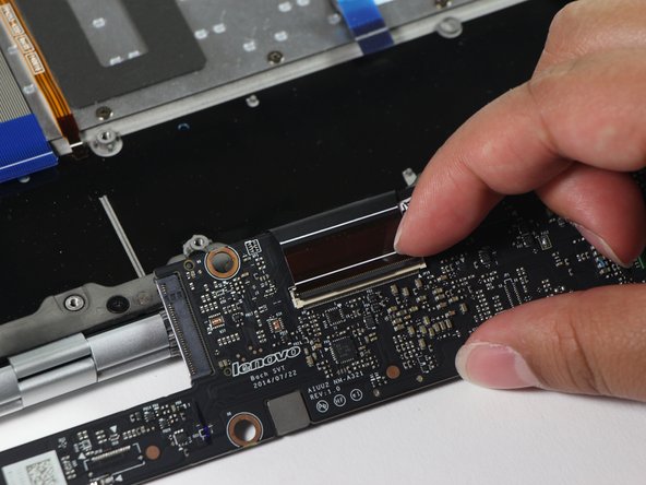

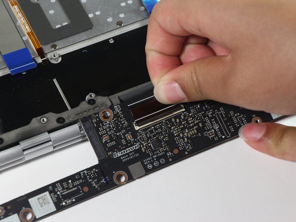

    • Flip the cable lock holding down the monitor connector.
    • Remove the monitor connector by tugging on the tab.
