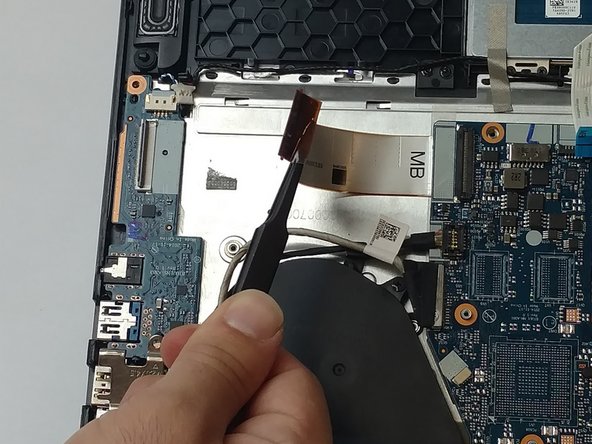

  6. Lenovo Yoga 3 14 USB Port Replacement: crwdns2935265:06crwdnd2935265:01crwdnd2935265:02crwdne2935265:0 Lenovo Yoga 3 14 USB Port Replacement: crwdns2935265:06crwdnd2935265:02crwdnd2935265:02crwdne2935265:0
    • Using the tweezers, carefully lift the black clip and remove the electrical ribbon.
