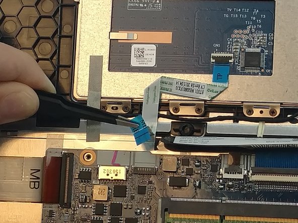

  6. Lenovo Yoga 3 14 Speaker Replacement: crwdns2935265:06crwdnd2935265:01crwdnd2935265:02crwdne2935265:0 Lenovo Yoga 3 14 Speaker Replacement: crwdns2935265:06crwdnd2935265:02crwdnd2935265:02crwdne2935265:0
    • Flip up the black retaining flap on the ZIF connector.
    • Using tweezers, gently disconnect the blue strip that connects the touch pad to the motherboard.

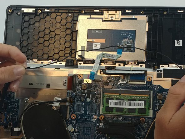

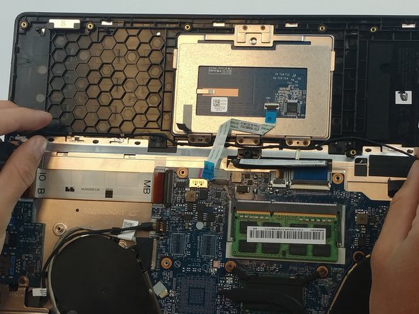

  7. Lenovo Yoga 3 14 Speaker Replacement: crwdns2935265:07crwdnd2935265:01crwdnd2935265:02crwdne2935265:0 Lenovo Yoga 3 14 Speaker Replacement: crwdns2935265:07crwdnd2935265:02crwdnd2935265:02crwdne2935265:0
    • Use tweezers to gently pull off tape that is holding down wires that are connecting the two speakers together.

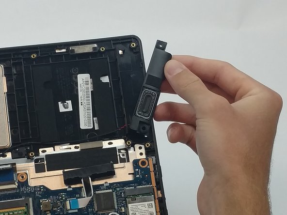

    • Both speakers are held in place by plastic pegs. Gently lift the speakers off the casing to remove them.
  9. Lenovo Yoga 3 14 Speaker Replacement: crwdns2935265:09crwdnd2935265:01crwdnd2935265:02crwdne2935265:0 Lenovo Yoga 3 14 Speaker Replacement: crwdns2935265:09crwdnd2935265:02crwdnd2935265:02crwdne2935265:0
    • Simply grip the speaker wires and lift away from laptop to remove.
