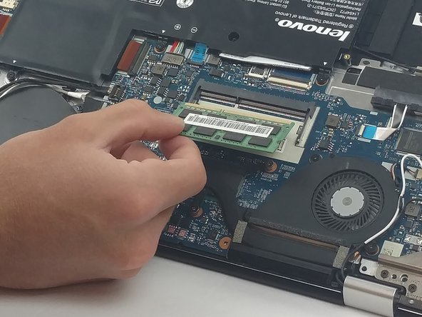

    • Remove the eleven 6mm T5 Torx screws from the back case.
  2. Lenovo Yoga 3 14 Ram Replacement: crwdns2935265:02crwdnd2935265:01crwdnd2935265:03crwdne2935265:0 Lenovo Yoga 3 14 Ram Replacement: crwdns2935265:02crwdnd2935265:02crwdnd2935265:03crwdne2935265:0 Lenovo Yoga 3 14 Ram Replacement: crwdns2935265:02crwdnd2935265:03crwdnd2935265:03crwdne2935265:0
    • Insert the plastic opening tool into the long side of the case backing and slide it the entire length of the laptop.
    • Gently lift the backing off the laptop.
  3. Lenovo Yoga 3 14 Ram Replacement, Ram: crwdns2935265:03crwdnd2935265:01crwdnd2935265:02crwdne2935265:0 Lenovo Yoga 3 14 Ram Replacement, Ram: crwdns2935265:03crwdnd2935265:02crwdnd2935265:02crwdne2935265:0
    • Using your thumbs, gently push the two clips away from the RAM.
  4. Lenovo Yoga 3 14 Ram Replacement: crwdns2935265:04crwdnd2935265:01crwdnd2935265:02crwdne2935265:0 Lenovo Yoga 3 14 Ram Replacement: crwdns2935265:04crwdnd2935265:02crwdnd2935265:02crwdne2935265:0
    • After the clips are moved, the RAM will simply pop up.
    • Gently remove the ram.
