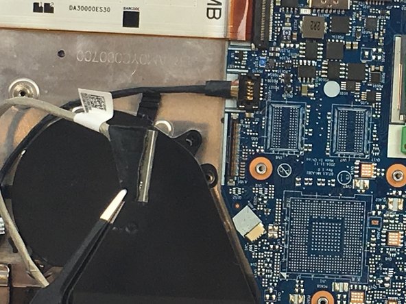

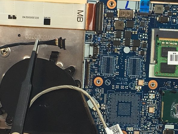

    • Use tweezers to disconnect the fan.
    • Unwrap the white and black wires from around the fan case.

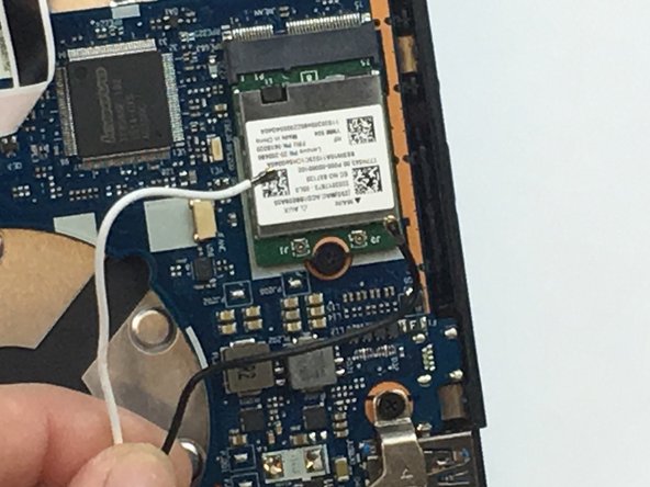

    • Using the tweezers, disconnect the white and black cables connecting the motherboard to the screen.

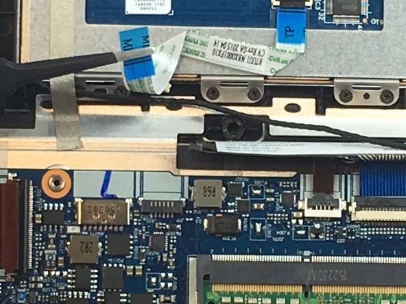

  12. Lenovo Yoga 3 14 Motherboard Replacement: crwdns2935265:012crwdnd2935265:01crwdnd2935265:02crwdne2935265:0 Lenovo Yoga 3 14 Motherboard Replacement: crwdns2935265:012crwdnd2935265:02crwdnd2935265:02crwdne2935265:0
    • Using tweezers, undo the plastic clip holding the ribbon in place and gently pull the ribbon to remove it.

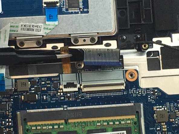

  13. Lenovo Yoga 3 14 Motherboard Replacement: crwdns2935265:013crwdnd2935265:01crwdnd2935265:02crwdne2935265:0 Lenovo Yoga 3 14 Motherboard Replacement: crwdns2935265:013crwdnd2935265:02crwdnd2935265:02crwdne2935265:0
    • Gently lift the clip holding down the blue ribbon connection the touch pad to the motherboard. Use tweezers to disconnect the ribbon.

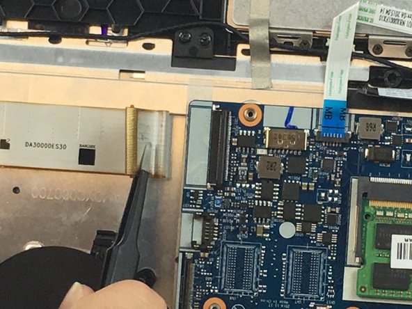

  14. Lenovo Yoga 3 14 Motherboard Replacement: crwdns2935265:014crwdnd2935265:01crwdnd2935265:02crwdne2935265:0 Lenovo Yoga 3 14 Motherboard Replacement: crwdns2935265:014crwdnd2935265:02crwdnd2935265:02crwdne2935265:0
    • Undo the clips holding the blue and brown ribbon to the motherboard. Use tweezers to gently remove both ribbons.
