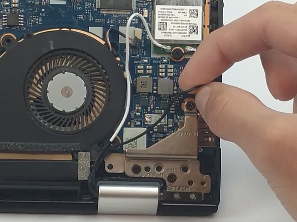

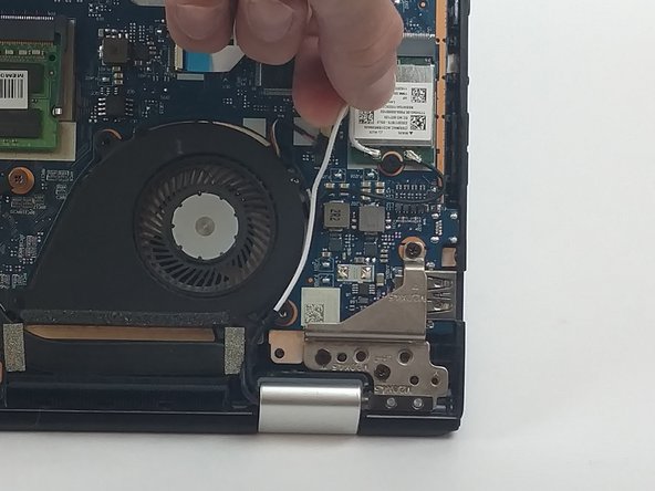

  4. Lenovo Yoga 3 14 Cooling Fan Replacement: crwdns2935265:04crwdnd2935265:01crwdnd2935265:03crwdne2935265:0 Lenovo Yoga 3 14 Cooling Fan Replacement: crwdns2935265:04crwdnd2935265:02crwdnd2935265:03crwdne2935265:0 Lenovo Yoga 3 14 Cooling Fan Replacement: crwdns2935265:04crwdnd2935265:03crwdnd2935265:03crwdne2935265:0
    • Use tweezers to disconnect the fan.
    • Unwrap the white and black wires from around the fan case.
  5. Lenovo Yoga 3 14 Cooling Fan Replacement: crwdns2935265:05crwdnd2935265:01crwdnd2935265:01crwdne2935265:0
    • Gently lift the fan out of the laptop.
