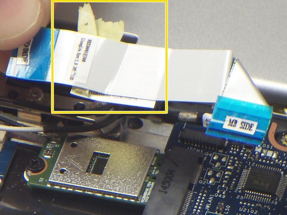

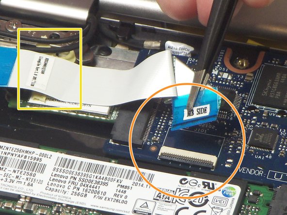

  11. Lenovo Yoga 3 11 Wireless Card Replacement: crwdns2935265:011crwdnd2935265:01crwdnd2935265:03crwdne2935265:0 Lenovo Yoga 3 11 Wireless Card Replacement: crwdns2935265:011crwdnd2935265:02crwdnd2935265:03crwdne2935265:0 Lenovo Yoga 3 11 Wireless Card Replacement: crwdns2935265:011crwdnd2935265:03crwdnd2935265:03crwdne2935265:0
    • Use a pair of tweezers to disconnect the "I/O Side" of the ribbon cable connecting the audio jack/USB port assembly to the motherboard. Gently lift up the black tab, and the ribbon cable should come free from the ZIF connector.
    • Use a pair of tweezers to disconnect the "MB Side" of the ribbon cable connecting the audio jack/USB port assembly to the motherboard. Gently lift up the black tab, and the ribbon cable should come free from the ZIF connector.
    • Remove the ribbon cable from the device.

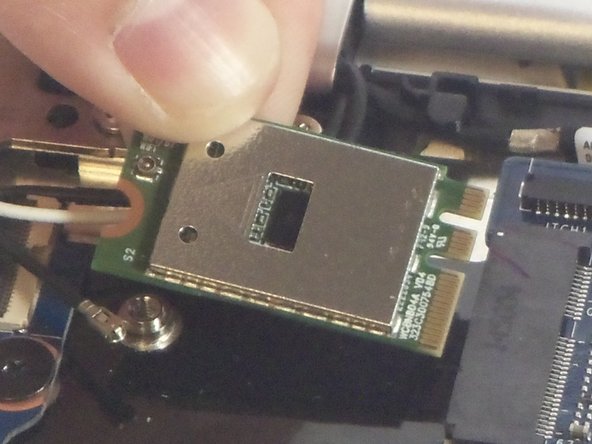

  12. Lenovo Yoga 3 11 Wireless Card Replacement: crwdns2935265:012crwdnd2935265:01crwdnd2935265:02crwdne2935265:0 Lenovo Yoga 3 11 Wireless Card Replacement: crwdns2935265:012crwdnd2935265:02crwdnd2935265:02crwdne2935265:0
    • Remove the single 2 mm Phillips #00 screws securing the wireless card.
    • Use a pair of tweezers to disconnect the black and white antenna cables that are connected to the wireless card.
    • Gently lift the wireless card up and out of the device.
