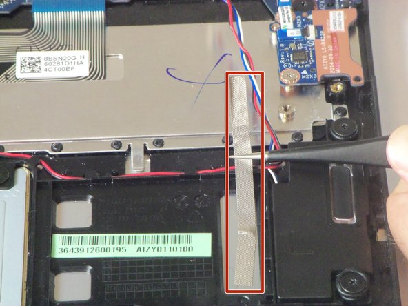

  6. Lenovo Yoga 3 11 Speaker Replacement, Speaker: crwdns2935265:06crwdnd2935265:01crwdnd2935265:02crwdne2935265:0 Lenovo Yoga 3 11 Speaker Replacement, Speaker: crwdns2935265:06crwdnd2935265:02crwdnd2935265:02crwdne2935265:0
    • Use a pair of tweezers to peel up one side of each of the 3 pieces of tape that cover the speaker wires.

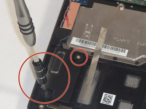

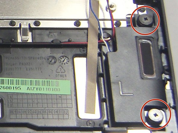

  8. Lenovo Yoga 3 11 Speaker Replacement: crwdns2935265:08crwdnd2935265:01crwdnd2935265:03crwdne2935265:0 Lenovo Yoga 3 11 Speaker Replacement: crwdns2935265:08crwdnd2935265:02crwdnd2935265:03crwdne2935265:0 Lenovo Yoga 3 11 Speaker Replacement: crwdns2935265:08crwdnd2935265:03crwdnd2935265:03crwdne2935265:0
    • Remove the two 2 mm Phillips #0 screws securing the left speaker.
    • Remove the two 2 mm Phillips #0 screws securing the right speaker.

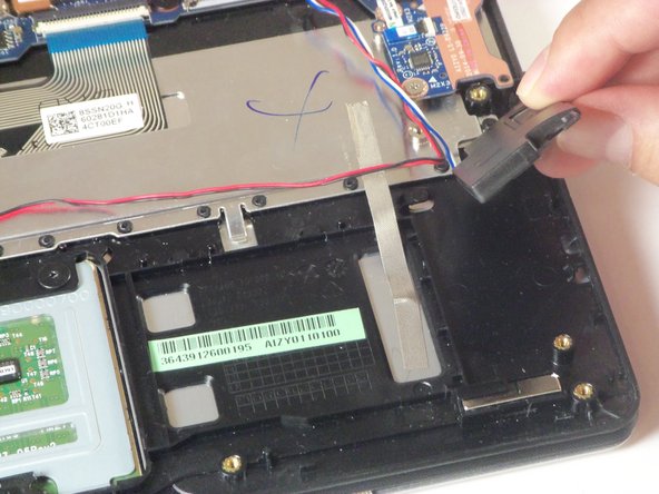

  9. Lenovo Yoga 3 11 Speaker Replacement: crwdns2935265:09crwdnd2935265:01crwdnd2935265:02crwdne2935265:0 Lenovo Yoga 3 11 Speaker Replacement: crwdns2935265:09crwdnd2935265:02crwdnd2935265:02crwdne2935265:0
    • Use a pair of tweezers to disconnect the speaker connector.
    • Gently lift the speakers free of the device.
