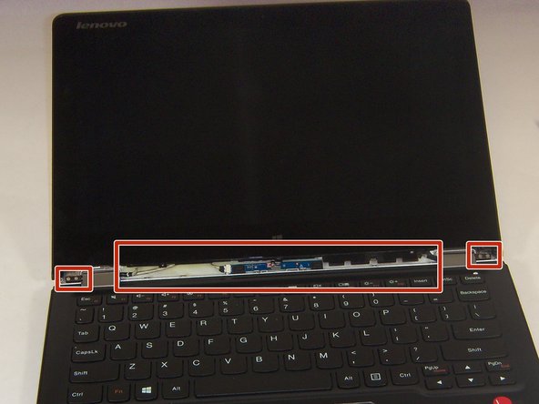

    • Use a plastic opening tool or the pointed end of a spudger to pry up the 2 rubber inserts in the bottom left and right corners of the screen.
  2. Lenovo Yoga 3 11 Screen Replacement: crwdns2935265:02crwdnd2935265:01crwdnd2935265:01crwdne2935265:0
    • Remove the single silver 5 mm screw found beneath each rubber insert.

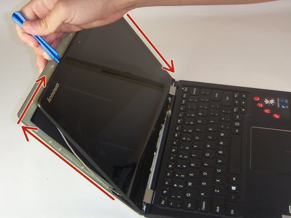

  4. Lenovo Yoga 3 11 Screen Replacement: crwdns2935265:04crwdnd2935265:01crwdnd2935265:02crwdne2935265:0 Lenovo Yoga 3 11 Screen Replacement: crwdns2935265:04crwdnd2935265:02crwdnd2935265:02crwdne2935265:0
    • Work the plastic opening tool in between bezel and the upper case.
    • Once the plastic opening tool is wedged in between the two, work the plastic opening tool around the perimeter of the screen, separating the bezel from the display.

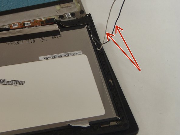

  7. Lenovo Yoga 3 11 Screen Replacement: crwdns2935265:07crwdnd2935265:01crwdnd2935265:01crwdne2935265:0
    • Use the tweezers to follow the wires and move them out from under the plastic hooks.

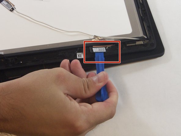

  8. Lenovo Yoga 3 11 Screen Replacement: crwdns2935265:08crwdnd2935265:01crwdnd2935265:01crwdne2935265:0
    • Use the tweezers to unplug the connector near the top of the screen.

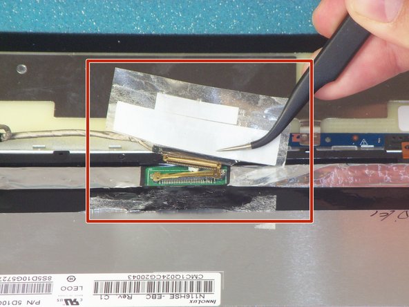

  9. Lenovo Yoga 3 11 Screen Replacement: crwdns2935265:09crwdnd2935265:01crwdnd2935265:01crwdne2935265:0
    • Use the tweezers to pull the tape upwards in order to free the wires underneath it.
