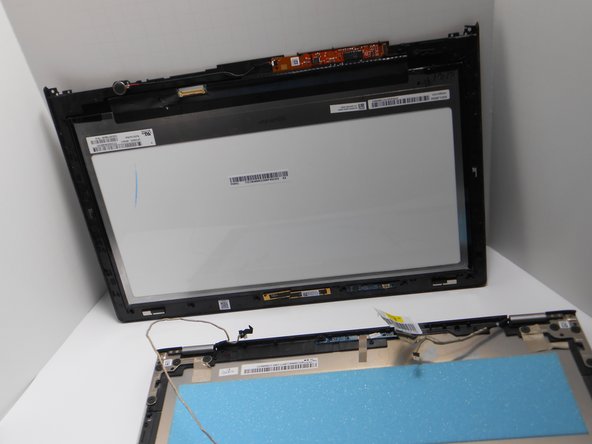

      • Using an opening pick, remove one small black rectangle piece on each of the hinge corners to locate screws.
      • Using a Phillips head screwdriver, carefully remove one 4.8 mm screw from each corner.
    2. Lenovo Yoga 2 13" Screen Replacement: crwdns2935265:02crwdnd2935265:01crwdnd2935265:01crwdne2935265:0
      • Using the Jimmy, remove the long centerpiece covering between the hinges.
    3. Lenovo Yoga 2 13" Screen Replacement: crwdns2935265:03crwdnd2935265:01crwdnd2935265:01crwdne2935265:0
      • Detach the screen from the front panel by sliding the screen up about 2mm. Do not pull too far, as there are still connected wires.
    4. Lenovo Yoga 2 13" Screen Replacement: crwdns2935265:04crwdnd2935265:01crwdnd2935265:01crwdne2935265:0
      • Locate the gold wire and follow it to two clips. Remove the clips and the clear tape securing the wire.
      • Gently unsnap the wire from the hooks along the perimeter, and remove any tape along the wire.
    5. Lenovo Yoga 2 13" Screen Replacement: crwdns2935265:05crwdnd2935265:01crwdnd2935265:02crwdne2935265:0 Lenovo Yoga 2 13" Screen Replacement: crwdns2935265:05crwdnd2935265:02crwdnd2935265:02crwdne2935265:0
      • Completely separate the screen from the laptop.
      • During reassembly, remember to set the screen about 2 mm beyond the lid top edge. Then, slide down to engage the hinges.

thanks for your guide. Step 1 and 2 - no problem. But how actually did you do step 3? I can't detach the screen, I can just lift it a few millimeters at the corners or at the side, totally hard..
edit: Ok got it: slide the touch-lcd up a bit :)
