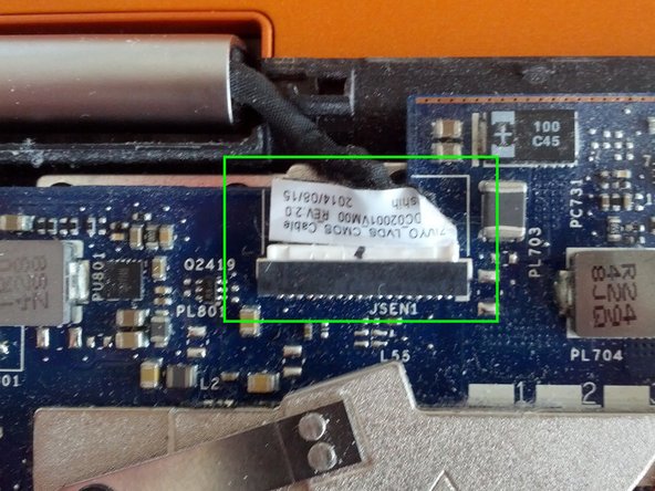

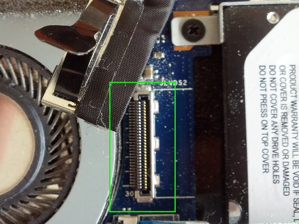

  3. Lenovo Yoga 2 13" Hinge Bracket Fix, Loosening the connectors: crwdns2935265:03crwdnd2935265:01crwdnd2935265:03crwdne2935265:0 Lenovo Yoga 2 13" Hinge Bracket Fix, Loosening the connectors: crwdns2935265:03crwdnd2935265:02crwdnd2935265:03crwdne2935265:0 Lenovo Yoga 2 13" Hinge Bracket Fix, Loosening the connectors: crwdns2935265:03crwdnd2935265:03crwdnd2935265:03crwdne2935265:0
    • The video connector can be pulled out with the attached noose. Pull gently possibly supported by lifting the connector with a screwdriver.
    • The other connector can be pushed out on the sides with the help of a screwdriver.

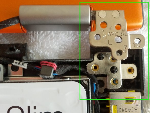

  4. Lenovo Yoga 2 13" Hinge Bracket Fix, Detach hinge.: crwdns2935265:04crwdnd2935265:01crwdnd2935265:02crwdne2935265:0 Lenovo Yoga 2 13" Hinge Bracket Fix, Detach hinge.: crwdns2935265:04crwdnd2935265:02crwdnd2935265:02crwdne2935265:0
    • Unscrew three screws to detach the hinge from the body.

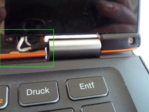

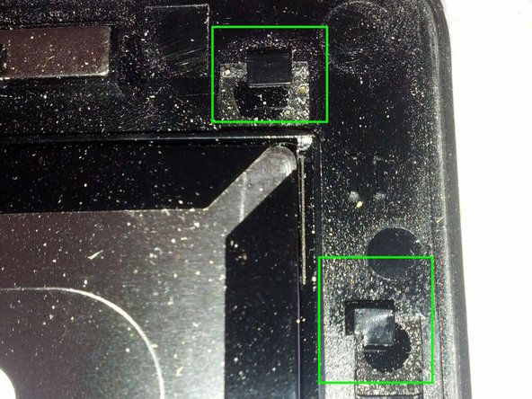

  5. Lenovo Yoga 2 13" Hinge Bracket Fix, Lay open the display.: crwdns2935265:05crwdnd2935265:01crwdnd2935265:03crwdne2935265:0 Lenovo Yoga 2 13" Hinge Bracket Fix, Lay open the display.: crwdns2935265:05crwdnd2935265:02crwdnd2935265:03crwdne2935265:0 Lenovo Yoga 2 13" Hinge Bracket Fix, Lay open the display.: crwdns2935265:05crwdnd2935265:03crwdnd2935265:03crwdne2935265:0

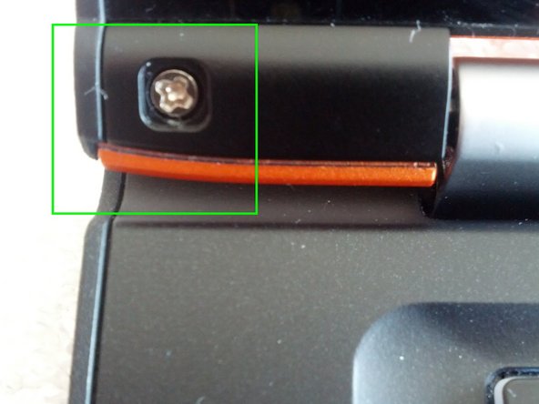

    • Peel out a small plastic cover, pull out center cover and unscrew left and right cover below the display.

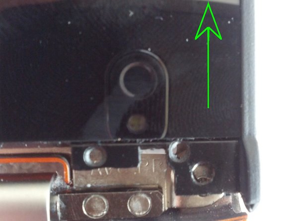

  6. Lenovo Yoga 2 13" Hinge Bracket Fix, Removing the display.: crwdns2935265:06crwdnd2935265:01crwdnd2935265:03crwdne2935265:0 Lenovo Yoga 2 13" Hinge Bracket Fix, Removing the display.: crwdns2935265:06crwdnd2935265:02crwdnd2935265:03crwdne2935265:0 Lenovo Yoga 2 13" Hinge Bracket Fix, Removing the display.: crwdns2935265:06crwdnd2935265:03crwdnd2935265:03crwdne2935265:0
    • Once the two screws are loosened, the whole display can be shifted up - don't just pull it away.
    • On reassembly, put the display and cover together slightly shifted, and then gently slide the display back into position.

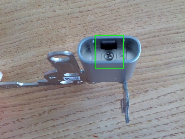

  7. Lenovo Yoga 2 13" Hinge Bracket Fix, Free the hinge: crwdns2935265:07crwdnd2935265:01crwdnd2935265:03crwdne2935265:0 Lenovo Yoga 2 13" Hinge Bracket Fix, Free the hinge: crwdns2935265:07crwdnd2935265:02crwdnd2935265:03crwdne2935265:0 Lenovo Yoga 2 13" Hinge Bracket Fix, Free the hinge: crwdns2935265:07crwdnd2935265:03crwdnd2935265:03crwdne2935265:0
    • The hinge is attached to the lid with four screws.

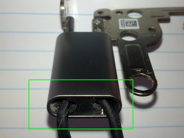

    • A cable runs through each hinge, you can just pull out the small rubbery holder.
    • Loosen the screw below it to open the hinge.
  8. Lenovo Yoga 2 13" Hinge Bracket Fix, Adjustening the hinge stiffness.: crwdns2935265:08crwdnd2935265:01crwdnd2935265:01crwdne2935265:0
    • The stiffness of the hinge can be adjusted by loosening the small nuts. One eighth of a turn might be enough - you will have to repeat adjusting them until the hinge has the right stiffness.

what type of nuts are showing in last step? those are hexagonal nuts but with what size?
Wara - crwdns2934203:0crwdne2934203:0
Just followed this howto on my Yoga 2 13: the size of the bolts is 4.5. I know because I only have 4 and 5 sized tools, and they didn't fit. I used pliers too, it works.
Stéphane L -
