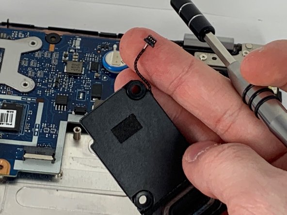

  7. Lenovo Yoga 2 11" 20428 Speaker Replacement, Speaker: crwdns2935265:07crwdnd2935265:01crwdnd2935265:01crwdne2935265:0
    • Use the Phillips #000 screwdriver to unscrew the four 1.7 mm screws.
  8. Lenovo Yoga 2 11" 20428 Speaker Replacement: crwdns2935265:08crwdnd2935265:01crwdnd2935265:02crwdne2935265:0 Lenovo Yoga 2 11" 20428 Speaker Replacement: crwdns2935265:08crwdnd2935265:02crwdnd2935265:02crwdne2935265:0
    • Carefully detach the speaker wire and remove the speaker.
