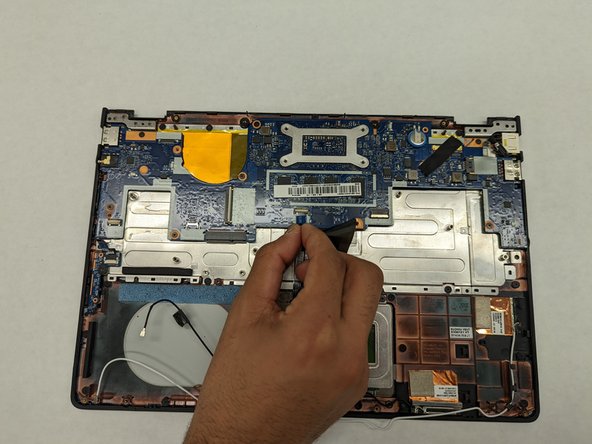

  13. Lenovo Yoga 2 11" 20428 Motherboard Replacement, Motherboard: crwdns2935265:013crwdnd2935265:01crwdnd2935265:01crwdne2935265:0
    • Using your finger nail or a thin pry tool, unlock and remove the three cables.
    • Lift the two pieces of tape. Carefully pull the cable connector back to remove it from the motherboard.
    • Use the Phillips #000 screwdriver to remove the eight 3.8mm screws.

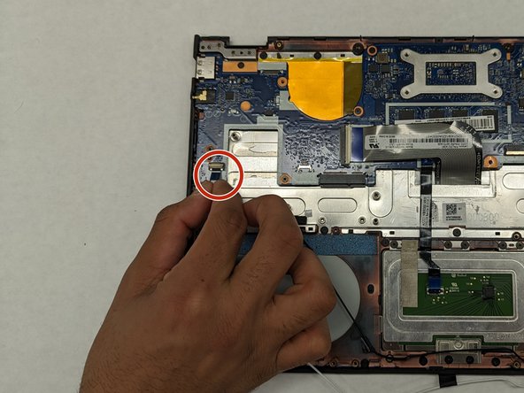

  14. Lenovo Yoga 2 11" 20428 Motherboard Replacement: crwdns2935265:014crwdnd2935265:01crwdnd2935265:02crwdne2935265:0 Lenovo Yoga 2 11" 20428 Motherboard Replacement: crwdns2935265:014crwdnd2935265:02crwdnd2935265:02crwdne2935265:0
    • Gently pull the cable out of the connector.
  15. Lenovo Yoga 2 11" 20428 Motherboard Replacement: crwdns2935265:015crwdnd2935265:01crwdnd2935265:02crwdne2935265:0 Lenovo Yoga 2 11" 20428 Motherboard Replacement: crwdns2935265:015crwdnd2935265:02crwdnd2935265:02crwdne2935265:0
    • Lift the wide cable in the center to reveal the port for the small cable underneath.
    • Using a fingernail or a thin pry tool, lift the white bar to release the cable.
    • Remove the cable from the connector.

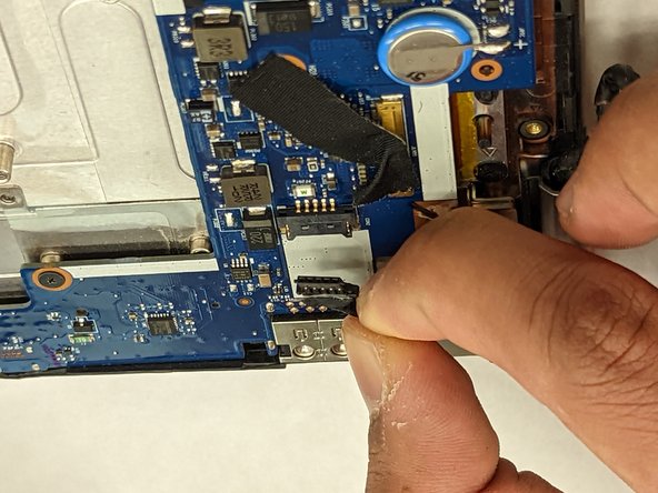

  18. Lenovo Yoga 2 11" 20428 Motherboard Replacement: crwdns2935265:018crwdnd2935265:01crwdnd2935265:01crwdne2935265:0
    • Pull the cable straight backwards to remove it.
  19. Lenovo Yoga 2 11" 20428 Motherboard Replacement: crwdns2935265:019crwdnd2935265:01crwdnd2935265:02crwdne2935265:0 Lenovo Yoga 2 11" 20428 Motherboard Replacement: crwdns2935265:019crwdnd2935265:02crwdnd2935265:02crwdne2935265:0
