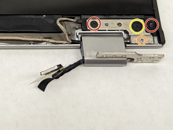

  4. Lenovo Yoga 2 11" 20428 Display Replacement: crwdns2935265:04crwdnd2935265:01crwdnd2935265:03crwdne2935265:0 Lenovo Yoga 2 11" 20428 Display Replacement: crwdns2935265:04crwdnd2935265:02crwdnd2935265:03crwdne2935265:0 Lenovo Yoga 2 11" 20428 Display Replacement: crwdns2935265:04crwdnd2935265:03crwdnd2935265:03crwdne2935265:0
    • Remove the 2.8mm screws.
    • Remove the 5mm screws.
    • Remove the 2.4mm screws.

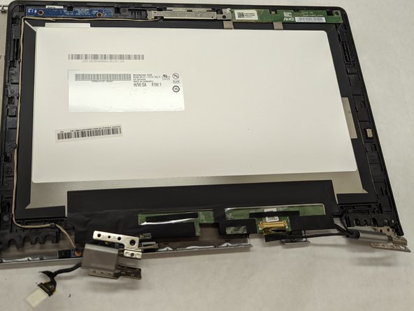

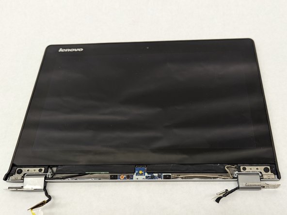

  5. Lenovo Yoga 2 11" 20428 Display Replacement: crwdns2935265:05crwdnd2935265:01crwdnd2935265:02crwdne2935265:0 Lenovo Yoga 2 11" 20428 Display Replacement: crwdns2935265:05crwdnd2935265:02crwdnd2935265:02crwdne2935265:0
    • Remove the front cover of the display
  6. Lenovo Yoga 2 11" 20428 Display Replacement: crwdns2935265:06crwdnd2935265:01crwdnd2935265:01crwdne2935265:0
    • Unplug the button sensor board.
    • Do not damage the teeth. Damaging the teeth of the sensor board may require you to replace the part.

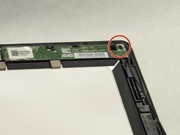

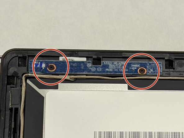

  7. Lenovo Yoga 2 11" 20428 Display Replacement: crwdns2935265:07crwdnd2935265:01crwdnd2935265:02crwdne2935265:0 Lenovo Yoga 2 11" 20428 Display Replacement: crwdns2935265:07crwdnd2935265:02crwdnd2935265:02crwdne2935265:0
    • Remove the 2.1 mm screws from the brightness sensor board.
  8. Lenovo Yoga 2 11" 20428 Display Replacement: crwdns2935265:08crwdnd2935265:01crwdnd2935265:02crwdne2935265:0 Lenovo Yoga 2 11" 20428 Display Replacement: crwdns2935265:08crwdnd2935265:02crwdnd2935265:02crwdne2935265:0
    • Remove the 3.3 mm screw on the camera.
    • Removal of the camera will result in the connecting wire to be disconnected as well

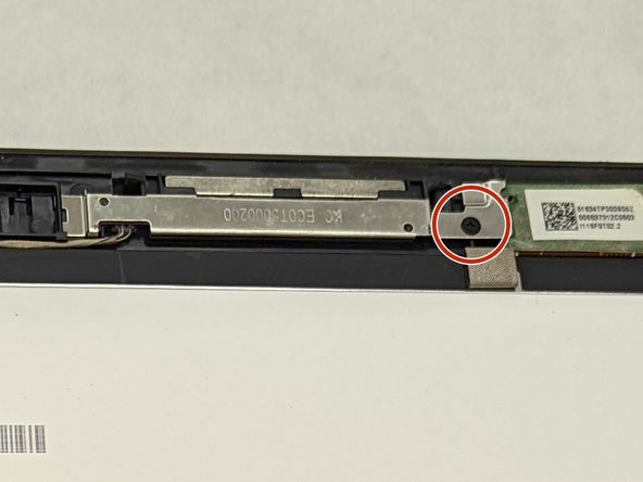

  9. Lenovo Yoga 2 11" 20428 Display Replacement: crwdns2935265:09crwdnd2935265:01crwdnd2935265:02crwdne2935265:0 Lenovo Yoga 2 11" 20428 Display Replacement: crwdns2935265:09crwdnd2935265:02crwdnd2935265:02crwdne2935265:0
    • Remove the 3.3 mm screw on the touch control board.

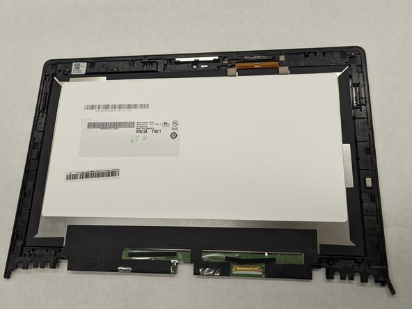

  10. Lenovo Yoga 2 11" 20428 Display Replacement: crwdns2935265:010crwdnd2935265:01crwdnd2935265:02crwdne2935265:0 Lenovo Yoga 2 11" 20428 Display Replacement: crwdns2935265:010crwdnd2935265:02crwdnd2935265:02crwdne2935265:0
    • Remove the touch control board
    • Do not damage the teeth. Damaging the teeth may call for replacement of the part.
    • Removal of the touch control board will result in the connecting wires to be removed as well
