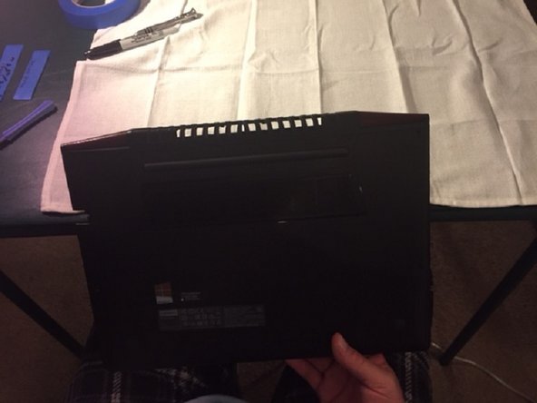

  1. Lenovo Y700-14ISK Upgrading/Replacing RAM Replacement, Remove the back Panel: crwdns2935265:01crwdnd2935265:01crwdnd2935265:02crwdne2935265:0 Lenovo Y700-14ISK Upgrading/Replacing RAM Replacement, Remove the back Panel: crwdns2935265:01crwdnd2935265:02crwdnd2935265:02crwdne2935265:0
    • Unscrew and take out 10, 1/5 cm screws.
    • Unscrew and take out 1, 1 inch screw.
    • I use a piece of tape sticky side up to place screws on, also I label it where they go.

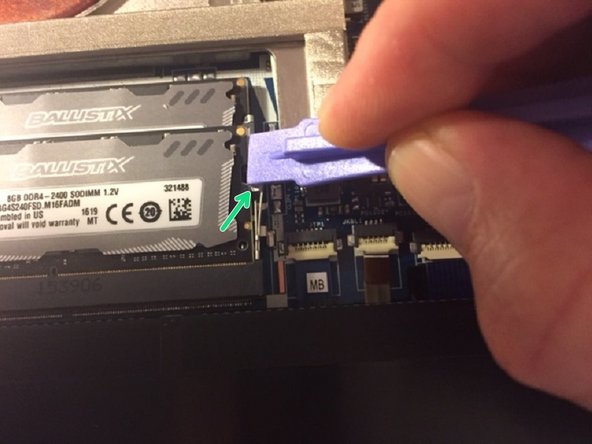

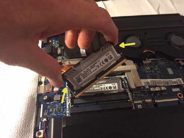

  5. Lenovo Y700-14ISK Upgrading/Replacing RAM Replacement, Removing the RAM: crwdns2935265:05crwdnd2935265:01crwdnd2935265:03crwdne2935265:0 Lenovo Y700-14ISK Upgrading/Replacing RAM Replacement, Removing the RAM: crwdns2935265:05crwdnd2935265:02crwdnd2935265:03crwdne2935265:0 Lenovo Y700-14ISK Upgrading/Replacing RAM Replacement, Removing the RAM: crwdns2935265:05crwdnd2935265:03crwdnd2935265:03crwdne2935265:0
    • Note the tabs on each side of the RAM holder,
    • With your fingers or the plastic tool gently move the tabs away from the RAM, the RAM should pop up when both sides or moved.
    • Grip the RAM by the sides and lift out.
