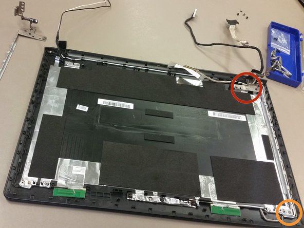

  13. Lenovo Y410P Hinges Replacement, Unscrew Hinges: crwdns2935265:013crwdnd2935265:01crwdnd2935265:02crwdne2935265:0 Lenovo Y410P Hinges Replacement, Unscrew Hinges: crwdns2935265:013crwdnd2935265:02crwdnd2935265:02crwdne2935265:0
    • After LCD screen has been removed, hinges will be revealed.
    • Remove four M2 x 3mm Phillips screws.
    • Two screws on each side, located towards bottom of hinges
    • Remove four m2 x 4mm Phillips screws.
    • Two screws on each side, located towards top of hinges
    • Hinges are now completely detached and may be lifted out of the back cover.
