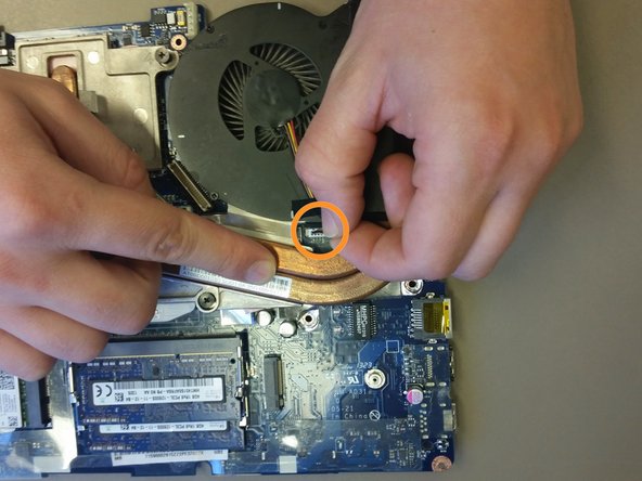

  8. Lenovo Y410P Cooling Fan Replacement, Unscrew Heatsink: crwdns2935265:08crwdnd2935265:01crwdnd2935265:02crwdne2935265:0 Lenovo Y410P Cooling Fan Replacement, Unscrew Heatsink: crwdns2935265:08crwdnd2935265:02crwdnd2935265:02crwdne2935265:0
    • Unscrew (adequately loosen) the six heatsink screws in the order written on the heatsink. Use a Phillips #0 screwdriver.
    • These six screws are built into the heatsink and will not detach from it.
    • Unplug the fan cable from the motherboard.

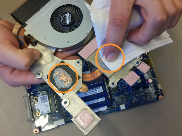

  10. Lenovo Y410P Cooling Fan Replacement, Remove Old Thermal Paste: crwdns2935265:010crwdnd2935265:01crwdnd2935265:02crwdne2935265:0 Lenovo Y410P Cooling Fan Replacement, Remove Old Thermal Paste: crwdns2935265:010crwdnd2935265:02crwdnd2935265:02crwdne2935265:0
    • Find an anti-microbial wipe and gently wipe the old thermal paste from the CPU and GPU
    • Now wipe the old thermal paste from the underside of the heatsink
    • Be careful not to mess up any of the pink thermal pads, these are important for other chips
  11. Lenovo Y410P Cooling Fan Replacement, Apply New Thermal Paste: crwdns2935265:011crwdnd2935265:01crwdnd2935265:01crwdne2935265:0
    • Apply new thermal paste to the CPU and GPU
    • Only apply a small bead approximately the size of a pea
