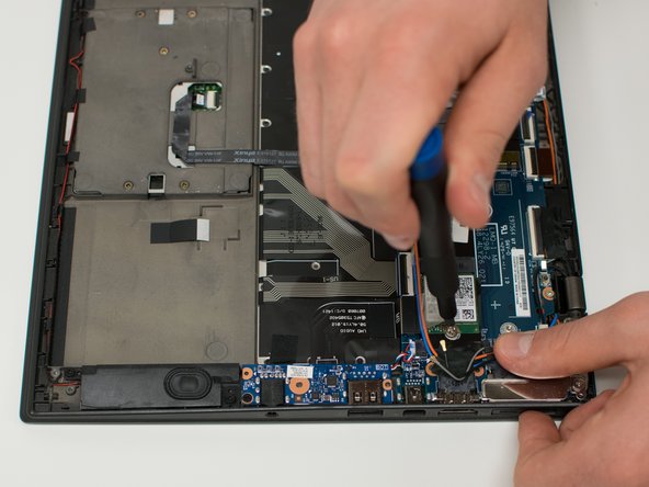

  4. Lenovo X1 Carbon Laptop Keyboard Replacement: crwdns2935265:04crwdnd2935265:01crwdnd2935265:02crwdne2935265:0 Lenovo X1 Carbon Laptop Keyboard Replacement: crwdns2935265:04crwdnd2935265:02crwdnd2935265:02crwdne2935265:0
    • Unplug the Local Area Network Card by prying the coaxial connectors straight up from the board.
    • Unscrew the 3mm screw from the LAN card.
    • Pull the LAN card straight out from its connector to remove it.

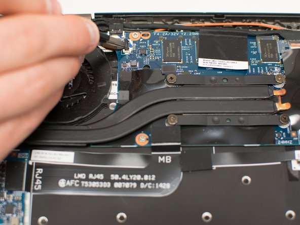

    • Unplug the CPU heatsink fan by flipping up the small locking flap on the ZIF connector and gently removing the cable.

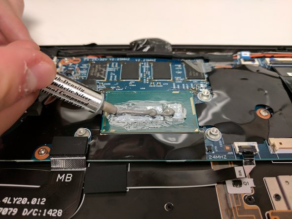

  6. Lenovo X1 Carbon Laptop Keyboard Replacement: crwdns2935265:06crwdnd2935265:01crwdnd2935265:02crwdne2935265:0 Lenovo X1 Carbon Laptop Keyboard Replacement: crwdns2935265:06crwdnd2935265:02crwdnd2935265:02crwdne2935265:0
    • Loosen the upper-left heat pipe screw.
    • Loosen the lower-right heat pipe screw.
    • Loosen the lower-left heat pipe screw.
    • Loosen the upper-right heat pipe screw.
    • Lift the CPU cooler straight up to remove it.
    • Thermal paste will need to be applied during reassembly.
    • Apply a small amount of thermal paste across the processor case.

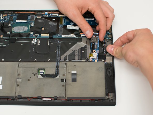

  9. Lenovo X1 Carbon Laptop Keyboard Replacement: crwdns2935265:09crwdnd2935265:01crwdnd2935265:03crwdne2935265:0 Lenovo X1 Carbon Laptop Keyboard Replacement: crwdns2935265:09crwdnd2935265:02crwdnd2935265:03crwdne2935265:0 Lenovo X1 Carbon Laptop Keyboard Replacement: crwdns2935265:09crwdnd2935265:03crwdnd2935265:03crwdne2935265:0

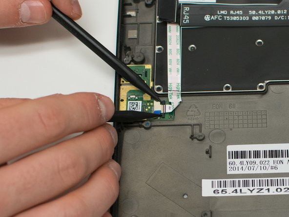

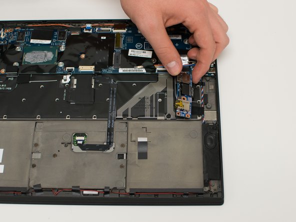

    • Disconnect the RJ45 ribbon cable by pulling straight up.
    • Remove the 4mm screw from the RJ45 card.
    • Move the RJ45 card slightly to the right and pull up to remove it.
  10. Lenovo X1 Carbon Laptop Keyboard Replacement: crwdns2935265:010crwdnd2935265:01crwdnd2935265:02crwdne2935265:0 Lenovo X1 Carbon Laptop Keyboard Replacement: crwdns2935265:010crwdnd2935265:02crwdnd2935265:02crwdne2935265:0
    • Remove the two 2.5mm screws from the guard.
    • Pull the guard straight up to remove it.
    • Slide the bottom plastic part of the ribbon cable socket forward.
    • Disconnect the ribbon cable.
    • Lift the fingerprint reader assembly straight up to remove it.

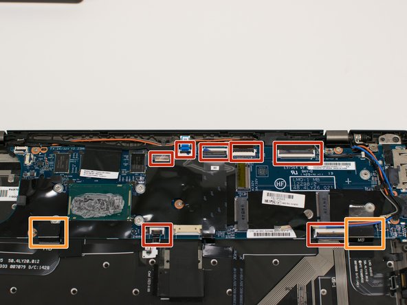

    • Do not subject the system board to excessive shock or electrostatic discharge of any sort.
    • Lift the ribbon cable locking mechanism.
    • Disconnect the ribbon cables by pulling straight out from the socket.
    • Disconnect the ribbon cables by pulling straight up.

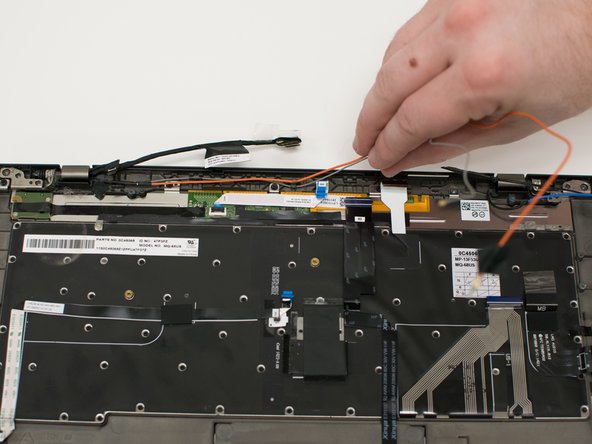

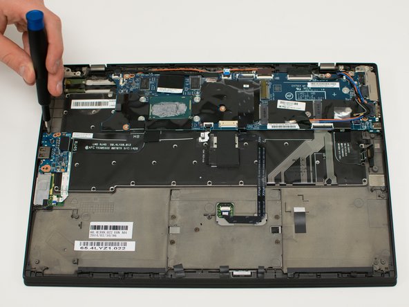

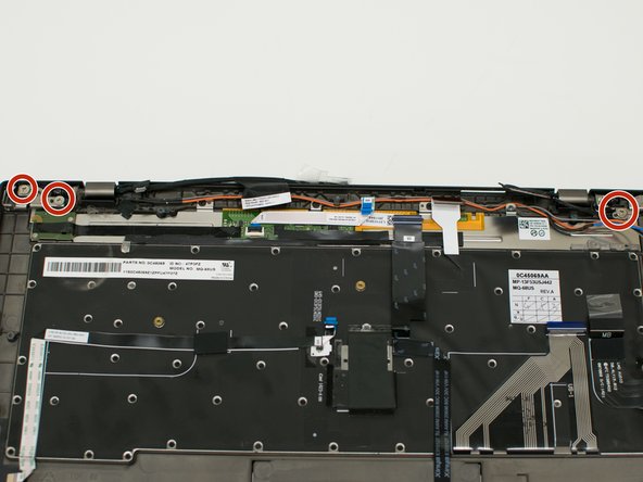

  14. Lenovo X1 Carbon Laptop Keyboard Replacement: crwdns2935265:014crwdnd2935265:01crwdnd2935265:03crwdne2935265:0 Lenovo X1 Carbon Laptop Keyboard Replacement: crwdns2935265:014crwdnd2935265:02crwdnd2935265:03crwdne2935265:0 Lenovo X1 Carbon Laptop Keyboard Replacement: crwdns2935265:014crwdnd2935265:03crwdnd2935265:03crwdne2935265:0
    • Remove the 4mm screw from the guard.
    • Remove the three 4mm screws from the LCD hinges.
    • Pull the antenna wires away from the hinges.

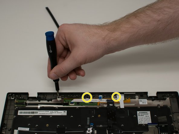

  16. Lenovo X1 Carbon Laptop Keyboard Replacement: crwdns2935265:016crwdnd2935265:01crwdnd2935265:03crwdne2935265:0 Lenovo X1 Carbon Laptop Keyboard Replacement: crwdns2935265:016crwdnd2935265:02crwdnd2935265:03crwdne2935265:0 Lenovo X1 Carbon Laptop Keyboard Replacement: crwdns2935265:016crwdnd2935265:03crwdnd2935265:03crwdne2935265:0
    • Remove the two 1.7mm screws from the bracket.
    • Remove the two 1.7mm screws from the adaptive keys panel.
    • Remove the three 2.5mm screws from the adaptive keys panel.
    • Lift the adaptive keys panel from the rear of the laptop and pull to remove it.

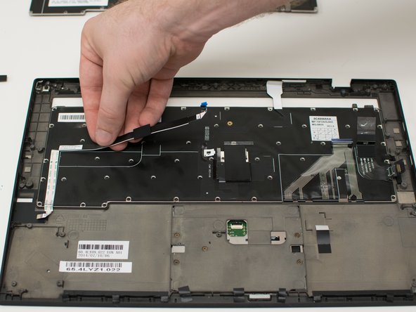

  17. Lenovo X1 Carbon Laptop Keyboard Replacement: crwdns2935265:017crwdnd2935265:01crwdnd2935265:03crwdne2935265:0 Lenovo X1 Carbon Laptop Keyboard Replacement: crwdns2935265:017crwdnd2935265:02crwdnd2935265:03crwdne2935265:0 Lenovo X1 Carbon Laptop Keyboard Replacement: crwdns2935265:017crwdnd2935265:03crwdnd2935265:03crwdne2935265:0

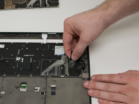

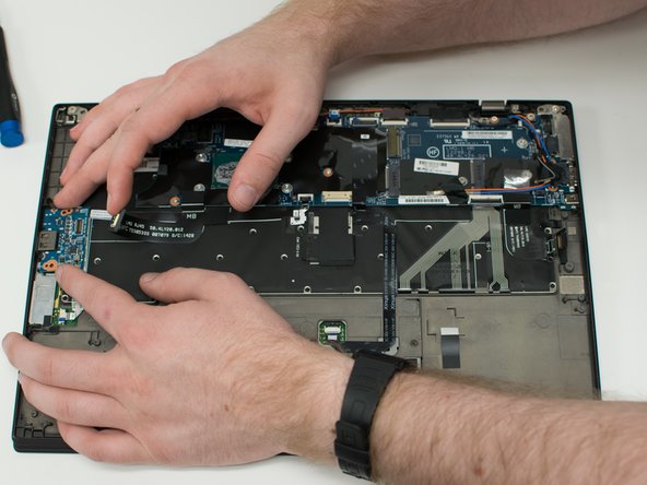

    • Remove the remaining ribbon cables from the back of the keyboard.
  18. Lenovo X1 Carbon Laptop Keyboard Replacement: crwdns2935265:018crwdnd2935265:01crwdnd2935265:03crwdne2935265:0 Lenovo X1 Carbon Laptop Keyboard Replacement: crwdns2935265:018crwdnd2935265:02crwdnd2935265:03crwdne2935265:0 Lenovo X1 Carbon Laptop Keyboard Replacement: crwdns2935265:018crwdnd2935265:03crwdnd2935265:03crwdne2935265:0
    • Remove the 45 Xmm screws from the back of the keyboard that are visible.
    • Remove the tape covering one of the Xmm screws and remove that screw.
    • Peel back the large ribbon cable and remove the four Xmm screws underneath it.
    • Lift the keyboard straight up to remove it.

Hey, I did this and have some serious Wi-Fi connection issues now…Ethernet and Wi-Fi are both listed as non-operational although sometimes a network will appear in my available networks to connect to. Any idea what might have gone wrong? I took out the LAN card and reinserted it, no dice.
D Walford - crwdns2934203:0crwdne2934203:0
You got the cables connected to the wrong little circle post on the wifi card. Swap them and it should work! happened to me drove me mad until I tried it.
