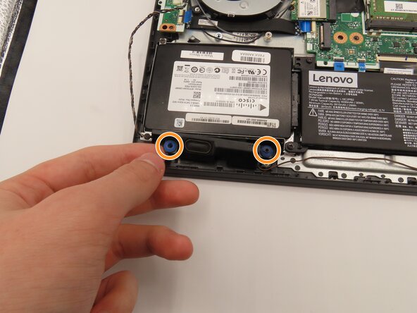

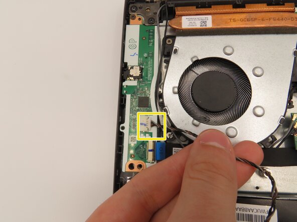

  4. Lenovo V14-ADA Speakers Replacement, Speakers: crwdns2935265:04crwdnd2935265:01crwdnd2935265:03crwdne2935265:0 Lenovo V14-ADA Speakers Replacement, Speakers: crwdns2935265:04crwdnd2935265:02crwdnd2935265:03crwdne2935265:0 Lenovo V14-ADA Speakers Replacement, Speakers: crwdns2935265:04crwdnd2935265:03crwdnd2935265:03crwdne2935265:0
    • Identify the 3 points where the speakers attach to the laptop.
    • Pull up on the blue caps to remove this part of the module. Repeat on the other side.
    • Pull the speaker wire out from its port.
    • Remove the speaker module.
