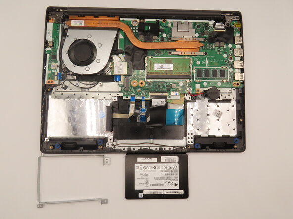

  5. Lenovo V14-ADA Hard Drive Replacement, Hard Drive: crwdns2935265:05crwdnd2935265:01crwdnd2935265:01crwdne2935265:0
    • Remove two 3 mm screws from the hard drive using a JIS #0 screwdriver.
  6. Lenovo V14-ADA Hard Drive Replacement: crwdns2935265:06crwdnd2935265:01crwdnd2935265:01crwdne2935265:0
    • Unplug the grey cable connecting the hard drive to the motherboard.
  7. Lenovo V14-ADA Hard Drive Replacement: crwdns2935265:07crwdnd2935265:01crwdnd2935265:02crwdne2935265:0 Lenovo V14-ADA Hard Drive Replacement: crwdns2935265:07crwdnd2935265:02crwdnd2935265:02crwdne2935265:0
    • Use the JIS #0 screwdriver to remove all four 3 mm bracket screws from the hard drive.
    • Remove the hard drive from the bracket.
