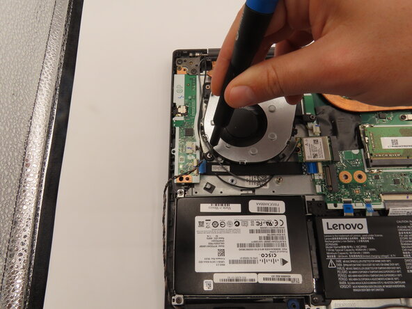

  4. Lenovo V14-ADA Fan Replacement, Fan: crwdns2935265:04crwdnd2935265:01crwdnd2935265:02crwdne2935265:0 Lenovo V14-ADA Fan Replacement, Fan: crwdns2935265:04crwdnd2935265:02crwdnd2935265:02crwdne2935265:0
    • Use a JIS #0 screwdriver to remove the three 6 mm screws holding the fan in place.
  5. Lenovo V14-ADA Fan Replacement: crwdns2935265:05crwdnd2935265:01crwdnd2935265:01crwdne2935265:0
    • Disconnect the white plug by pulling outwards.
    • Remove the fan from the laptop.
