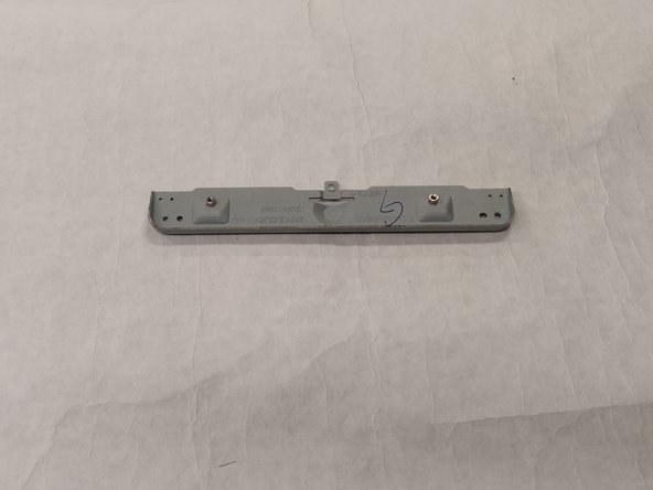

  3. Lenovo Touch Y70-70 Touchpad Replacement: crwdns2935265:03crwdnd2935265:01crwdnd2935265:02crwdne2935265:0 Lenovo Touch Y70-70 Touchpad Replacement: crwdns2935265:03crwdnd2935265:02crwdnd2935265:02crwdne2935265:0
    • Using the Phillips #0 screwdriver, remove the metal reinforcement by removing the three screws.

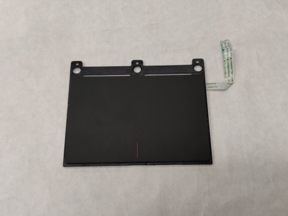

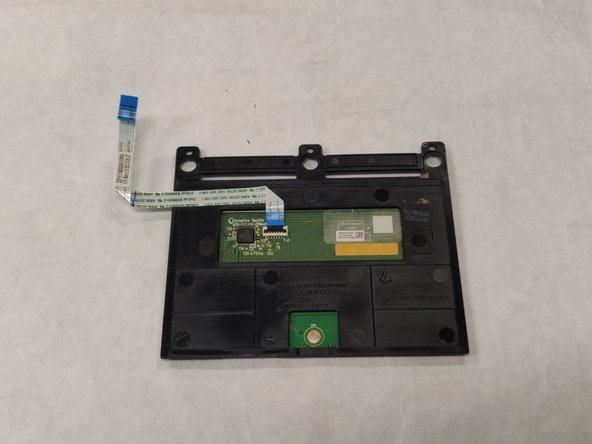

  5. Lenovo Touch Y70-70 Touchpad Replacement: crwdns2935265:05crwdnd2935265:01crwdnd2935265:03crwdne2935265:0 Lenovo Touch Y70-70 Touchpad Replacement: crwdns2935265:05crwdnd2935265:02crwdnd2935265:03crwdne2935265:0 Lenovo Touch Y70-70 Touchpad Replacement: crwdns2935265:05crwdnd2935265:03crwdnd2935265:03crwdne2935265:0
    • Using the Phillips #0 screwdriver, remove the three screws holding down the touchpad.
    • Using the spudger, remove the touchpad from the laptop.
