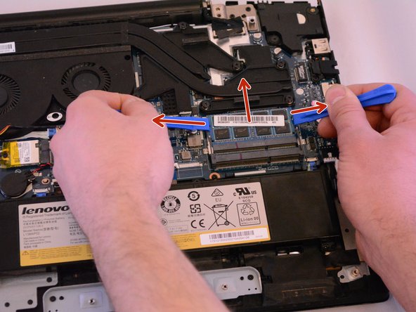

    • Flip the device so the back is facing you.
    • Using the Phillips #0 screwdriver, unscrew the fourteen screws from the device.
  2. Lenovo Touch Y70-70 RAM Replacement: crwdns2935265:02crwdnd2935265:01crwdnd2935265:01crwdne2935265:0
    • Use the blue Opening Tool to pry-open the back cover.
    • Slide it around the perimeter of the PC freeing the back cover.
    • Remove the back cover from the device.
  3. Lenovo Touch Y70-70 RAM Replacement, RAM: crwdns2935265:03crwdnd2935265:01crwdnd2935265:02crwdne2935265:0 Lenovo Touch Y70-70 RAM Replacement, RAM: crwdns2935265:03crwdnd2935265:02crwdnd2935265:02crwdne2935265:0
    • Use your fingers or two of the blue Opening Tools to lightly pull the tabs away from the RAM to free the first stick.
    • Remove the first stick and and do the same thing to the second RAM stick.
