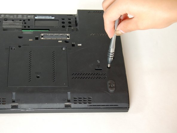

    • Remove five 5.7mm screws from the bottom.

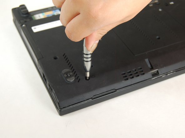

    • Unscrew two 5.7mm screws from the top of the bottom of the laptop.

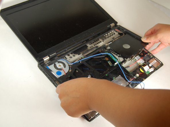

    • Pull the palm rest off the laptop board.
  18. Lenovo Thinkpad x230 Motherboard Replacement: crwdns2935265:018crwdnd2935265:01crwdnd2935265:02crwdne2935265:0 Lenovo Thinkpad x230 Motherboard Replacement: crwdns2935265:018crwdnd2935265:02crwdnd2935265:02crwdne2935265:0
    • Unlock the white seal and disconnect the blue cable.
  19. Lenovo Thinkpad x230 Motherboard Replacement: crwdns2935265:019crwdnd2935265:01crwdnd2935265:03crwdne2935265:0 Lenovo Thinkpad x230 Motherboard Replacement: crwdns2935265:019crwdnd2935265:02crwdnd2935265:03crwdne2935265:0 Lenovo Thinkpad x230 Motherboard Replacement: crwdns2935265:019crwdnd2935265:03crwdnd2935265:03crwdne2935265:0
    • Carefully disconnect blue and red cables and remove them from plastic case.

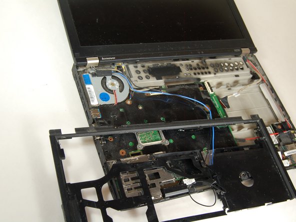

    • Remove two 4.1mm screws from the black frame.
  22. Lenovo Thinkpad x230 Motherboard Replacement: crwdns2935265:022crwdnd2935265:01crwdnd2935265:03crwdne2935265:0 Lenovo Thinkpad x230 Motherboard Replacement: crwdns2935265:022crwdnd2935265:02crwdnd2935265:03crwdne2935265:0 Lenovo Thinkpad x230 Motherboard Replacement: crwdns2935265:022crwdnd2935265:03crwdnd2935265:03crwdne2935265:0
    • Carefully pull off black frame from laptop board.

    • Carefully detach the motherboard (black plastic) from the laptop.
