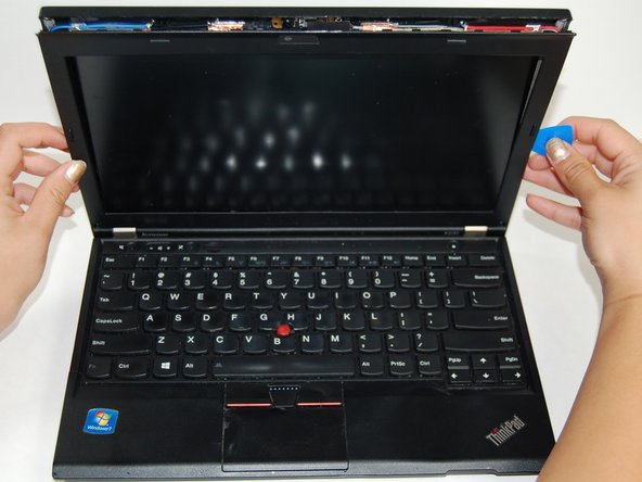

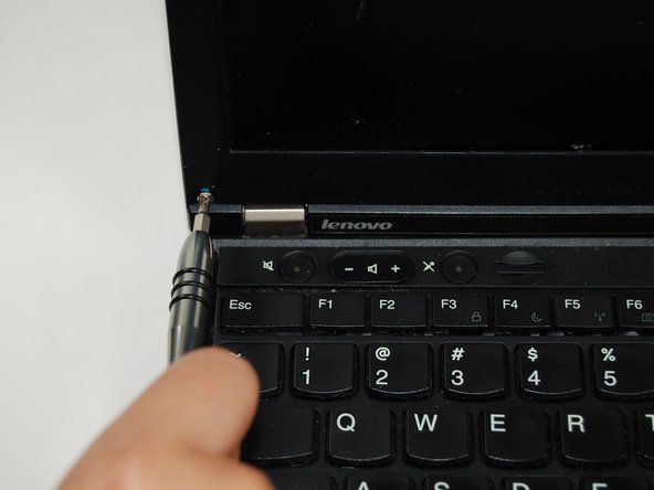

  5. Lenovo Thinkpad x230 Bezel Replacement, Bezel: crwdns2935265:05crwdnd2935265:01crwdnd2935265:01crwdne2935265:0
    • Remove the plastic screw covers with an iFixit opening pick.
  6. Lenovo Thinkpad x230 Bezel Replacement: crwdns2935265:06crwdnd2935265:01crwdnd2935265:02crwdne2935265:0 Lenovo Thinkpad x230 Bezel Replacement: crwdns2935265:06crwdnd2935265:02crwdnd2935265:02crwdne2935265:0
    • Remove the screws (0.4, 0.5 cm) from the bottom corners of the bezel using a Phillips #0 screwdriver.

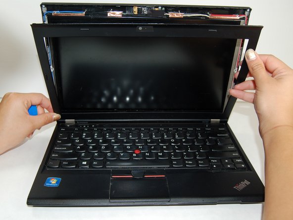

  7. Lenovo Thinkpad x230 Bezel Replacement: crwdns2935265:07crwdnd2935265:01crwdnd2935265:03crwdne2935265:0 Lenovo Thinkpad x230 Bezel Replacement: crwdns2935265:07crwdnd2935265:02crwdnd2935265:03crwdne2935265:0 Lenovo Thinkpad x230 Bezel Replacement: crwdns2935265:07crwdnd2935265:03crwdnd2935265:03crwdne2935265:0
    • Carefully remove the plastic bezel cover using an iFixit opening pick.
