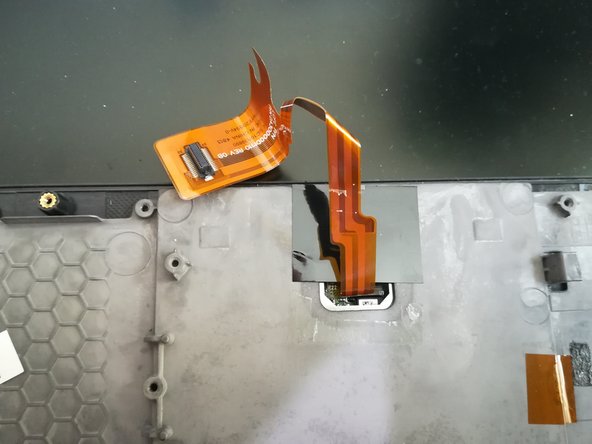

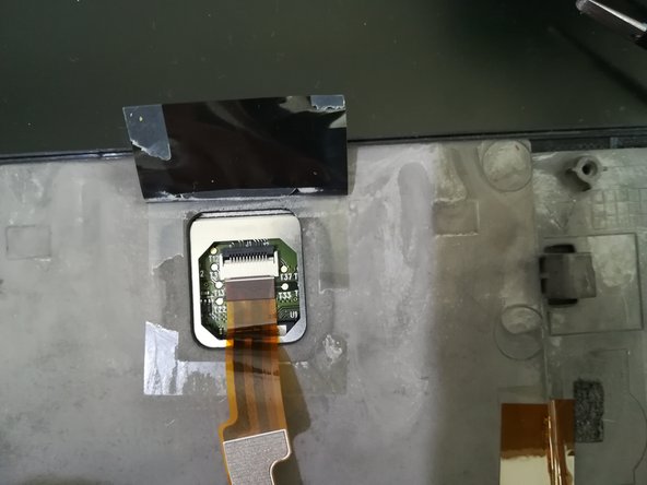

  6. Lenovo Thinkpad X240 Touchpad Replacement, Touchpad: crwdns2935265:06crwdnd2935265:01crwdnd2935265:03crwdne2935265:0 Lenovo Thinkpad X240 Touchpad Replacement, Touchpad: crwdns2935265:06crwdnd2935265:02crwdnd2935265:03crwdne2935265:0 Lenovo Thinkpad X240 Touchpad Replacement, Touchpad: crwdns2935265:06crwdnd2935265:03crwdnd2935265:03crwdne2935265:0
    • Remove backing from under the touchpad connector.
    • Once removed, there is a *second* backing underneath. This should be pulled up and away from the connections but not completely removed.
    • The connection to the touchpad will be revealed.
  7. Lenovo Thinkpad X240 Touchpad Replacement, Remove connector: crwdns2935265:07crwdnd2935265:01crwdnd2935265:01crwdne2935265:0
    • Remove connector to touchpad by easing the black tab on the white connector upwards, and using tweezers pull the connector downwards away from the connection.
    • This will be the most difficult connector to reconnect when you are reassembling, study it now and have the appropriate tools such as tweezers available.

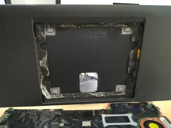

  8. Lenovo Thinkpad X240 Touchpad Replacement, Remove old touchpad: crwdns2935265:08crwdnd2935265:01crwdnd2935265:03crwdne2935265:0 Lenovo Thinkpad X240 Touchpad Replacement, Remove old touchpad: crwdns2935265:08crwdnd2935265:02crwdnd2935265:03crwdne2935265:0 Lenovo Thinkpad X240 Touchpad Replacement, Remove old touchpad: crwdns2935265:08crwdnd2935265:03crwdnd2935265:03crwdne2935265:0
    • As the touchpad is held in place by glue strips, the next steps are necessarily destructive . You should be prepared with a new touchpad that you have confirmed will work before removing the old one.
    • If you raise the keyboard frame to extract the touchpad, be careful of the two sides as they are not well supported and could easily snap.
    • You can remove the top part of the old touchpad by using a spudger or plastic tool to take it off the hinges.
    • Using a spudger between the frame and the touchpad get underneath and separate from the glue strip.
    • Once removed, you can see the old glue strip by raising the keyboard frame.
  9. Lenovo Thinkpad X240 Touchpad Replacement, Attached touchpad connector: crwdns2935265:09crwdnd2935265:01crwdnd2935265:02crwdne2935265:0 Lenovo Thinkpad X240 Touchpad Replacement, Attached touchpad connector: crwdns2935265:09crwdnd2935265:02crwdnd2935265:02crwdne2935265:0
    • Before pressing new touchpad onto glue strips, remember to install the connector. This will be much harder (although still possible) if you do it after putting the new touchpad in place.
    • As with other connectors, the black tab has to be raised vertical, ribbon cable inserted in, and then the black tab returned to the horizontal position to lock the cable in.
    • This was the most difficult action and required the use of two angled tweezers, so ensure you have appropriate tools before commencing this step.

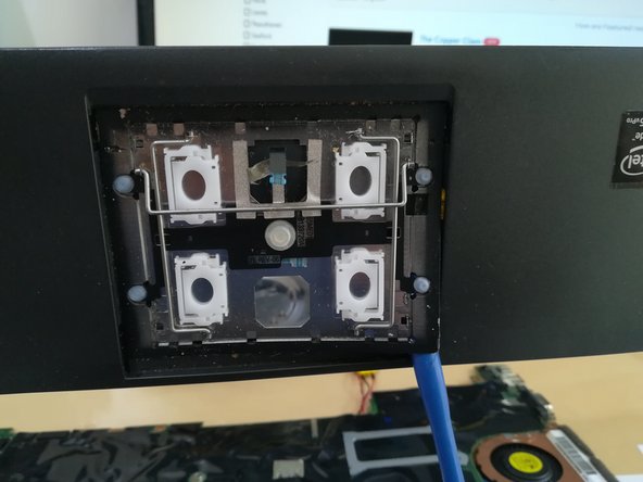

  10. Lenovo Thinkpad X240 Touchpad Replacement, Insert new touchpad: crwdns2935265:010crwdnd2935265:01crwdnd2935265:02crwdne2935265:0 Lenovo Thinkpad X240 Touchpad Replacement, Insert new touchpad: crwdns2935265:010crwdnd2935265:02crwdnd2935265:02crwdne2935265:0
    • The new touchpad should have the black tape reapplied in the same order as removal. There was the top piece to bend under the connector, then the larger black piece of tape over the top.
    • The connector should be folded and bent the correct way along with the other keyboard connectors and reattached to the motherboard.
As the touchpad is held in place only by glue strips, it would be wise to save some of the old ones and use them under the new touchpad.
