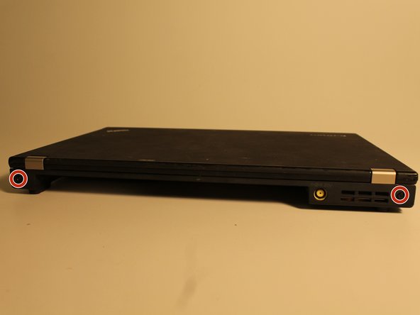

    • Remove the 2 screws that is holding the outline plate.
    • Close laptop.
    • From the backside remove the remaining two screws that are holding down the LCD screen.
    • Turn laptop around facing you and open back up exposing screen.

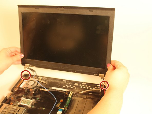

  6. Lenovo Thinkpad X220 LCD Screen Replacement: crwdns2935265:06crwdnd2935265:01crwdnd2935265:02crwdne2935265:0 Lenovo Thinkpad X220 LCD Screen Replacement: crwdns2935265:06crwdnd2935265:02crwdnd2935265:02crwdne2935265:0
    • Un-clamp the two silver wires.
    • Gently lift up on the screen and set the screen aside.
    • Replacing the new screen you will need to put the silver pegs into the designated spots.

This guide has more to do with replacing the whole upper half of your laptop (screen, frame, camera), which is not what I want or expect. Check out https://www.youtube.com/watch?v=7RwO6Zly... for a screen replacement only guide.
If you are just replacing your screen, you do not have to take out your keyboard, trackpad, et al.

This is a great guide for those who have purchased a whole screen/camera/antenna/microphone unit with the hinges attached. It worked great for me! My daughter has her laptop back for remote schoolwork due to COVID-19! Thanks!
The only part I’d add is that you really do have to take the outline plate out. It has plastic “snaps” on the left, top, and right sides. Once the outline plate has been removed, the hinges are free to be lifted out of the chassis. The snaps on the left and top were easy, but I wound up popping the right two snaps using a spudger. They survived the ordeal and were unbroken.
Also, kudos to Lenovo for building machines you can just repair with a screwdriver and spudger.
