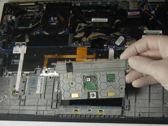

  10. Lenovo Thinkpad X1 Carbon 4th Gen Mouse Pad Replacement, Mouse Pad: crwdns2935265:010crwdnd2935265:01crwdnd2935265:01crwdne2935265:0
    • Using a Phillips #1 screwdriver, remove the six 2 mm screws securing the mousepad to the motherboard.
    • Using the plastic opening tool, lift the flap of the ZIF connector up and pull out the ribbon cable connecting the motherboard to the mousepad.
  11. Lenovo Thinkpad X1 Carbon 4th Gen Mouse Pad Replacement: crwdns2935265:011crwdnd2935265:01crwdnd2935265:02crwdne2935265:0 Lenovo Thinkpad X1 Carbon 4th Gen Mouse Pad Replacement: crwdns2935265:011crwdnd2935265:02crwdnd2935265:02crwdne2935265:0
    • Using the plastic opening tool, tilt and lift the mousepad away from the bottom of the computer.
    • Remove the mousepad.
    • If the mousepad is being fussy, you can also push it out from the keyboard side of the bottom panel.
