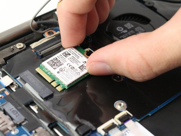

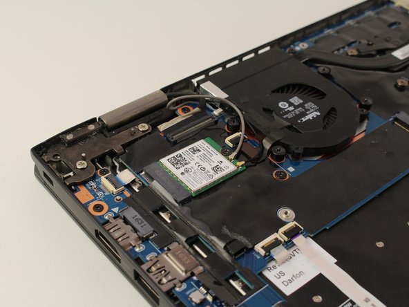

  12. Lenovo Thinkpad X1 Carbon 4th Gen Motherboard Replacement, Wireless LAN Card: crwdns2935265:012crwdnd2935265:01crwdnd2935265:02crwdne2935265:0 Lenovo Thinkpad X1 Carbon 4th Gen Motherboard Replacement, Wireless LAN Card: crwdns2935265:012crwdnd2935265:02crwdnd2935265:02crwdne2935265:0
    • Remove the protective film to the left of the fan assembly.
  13. Lenovo Thinkpad X1 Carbon 4th Gen Motherboard Replacement: crwdns2935265:013crwdnd2935265:01crwdnd2935265:03crwdne2935265:0 Lenovo Thinkpad X1 Carbon 4th Gen Motherboard Replacement: crwdns2935265:013crwdnd2935265:02crwdnd2935265:03crwdne2935265:0 Lenovo Thinkpad X1 Carbon 4th Gen Motherboard Replacement: crwdns2935265:013crwdnd2935265:03crwdnd2935265:03crwdne2935265:0
    • Carefully disconnect the gray and black antenna connectors on the green wireless LAN card by lifting under the antennas with an opening tool.
  14. Lenovo Thinkpad X1 Carbon 4th Gen Motherboard Replacement: crwdns2935265:014crwdnd2935265:01crwdnd2935265:01crwdne2935265:0
    • Remove the 2.5 mm screw holding the card in place with a Phillips #1 screwdriver.
  15. Lenovo Thinkpad X1 Carbon 4th Gen Motherboard Replacement: crwdns2935265:015crwdnd2935265:01crwdnd2935265:02crwdne2935265:0 Lenovo Thinkpad X1 Carbon 4th Gen Motherboard Replacement: crwdns2935265:015crwdnd2935265:02crwdnd2935265:02crwdne2935265:0
    • Carefully slide the wireless card out of the slot by pulling it to the right.

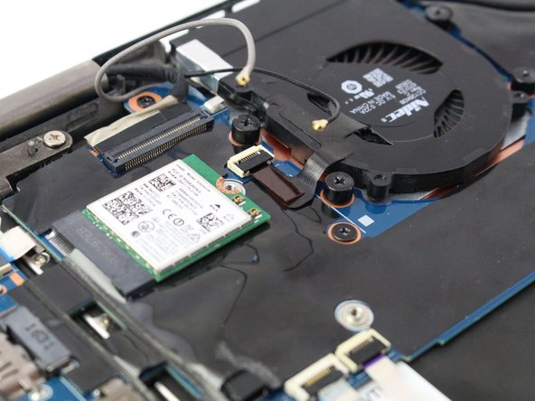

  16. Lenovo Thinkpad X1 Carbon 4th Gen Motherboard Replacement, Cooling Fan: crwdns2935265:016crwdnd2935265:01crwdnd2935265:02crwdne2935265:0 Lenovo Thinkpad X1 Carbon 4th Gen Motherboard Replacement, Cooling Fan: crwdns2935265:016crwdnd2935265:02crwdnd2935265:02crwdne2935265:0
    • Peel off the black protective film to the left of the fan.
  17. Lenovo Thinkpad X1 Carbon 4th Gen Motherboard Replacement: crwdns2935265:017crwdnd2935265:01crwdnd2935265:03crwdne2935265:0 Lenovo Thinkpad X1 Carbon 4th Gen Motherboard Replacement: crwdns2935265:017crwdnd2935265:02crwdnd2935265:03crwdne2935265:0 Lenovo Thinkpad X1 Carbon 4th Gen Motherboard Replacement: crwdns2935265:017crwdnd2935265:03crwdnd2935265:03crwdne2935265:0
    • Do not remove the four screws closest to the fan. They do not affect the fan assembly.
    • Disconnect the antenna wires on green the wireless LAN card to the left of the fan.
  18. Lenovo Thinkpad X1 Carbon 4th Gen Motherboard Replacement: crwdns2935265:018crwdnd2935265:01crwdnd2935265:03crwdne2935265:0 Lenovo Thinkpad X1 Carbon 4th Gen Motherboard Replacement: crwdns2935265:018crwdnd2935265:02crwdnd2935265:03crwdne2935265:0 Lenovo Thinkpad X1 Carbon 4th Gen Motherboard Replacement: crwdns2935265:018crwdnd2935265:03crwdnd2935265:03crwdne2935265:0
    • Lift up the hinge connector that is attached to the fan's ribbon cable.
    • Carefully disconnect the cable by pulling outwards from the ribbon connector.

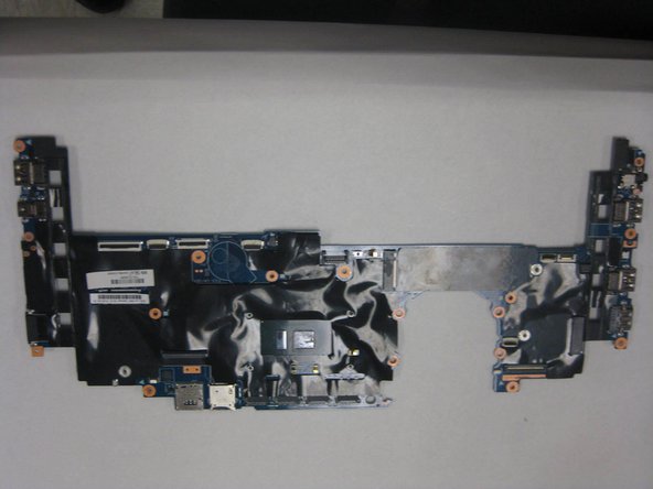

  22. Lenovo Thinkpad X1 Carbon 4th Gen Motherboard Replacement, Motherboard: crwdns2935265:022crwdnd2935265:01crwdnd2935265:01crwdne2935265:0
    • Using a Phillips #0 screwdriver, remove the two 5 mm screws securing the USB ports on the righthand side of the motherboard.
  23. Lenovo Thinkpad X1 Carbon 4th Gen Motherboard Replacement: crwdns2935265:023crwdnd2935265:01crwdnd2935265:02crwdne2935265:0 Lenovo Thinkpad X1 Carbon 4th Gen Motherboard Replacement: crwdns2935265:023crwdnd2935265:02crwdnd2935265:02crwdne2935265:0
    • The white triangle symbol on the motherboard identifies the longer 5mm length screws.
    • Using a Phillips #0 screwdriver, remove the five 5mm screws.
    • The white square symbol on the motherboard identifies 2mm length screws.
    • Using a Phillips #0 screwdriver, remove the four 2mm screws.
  24. Lenovo Thinkpad X1 Carbon 4th Gen Motherboard Replacement: crwdns2935265:024crwdnd2935265:01crwdnd2935265:01crwdne2935265:0
    • Remove the 7 ribbon cables connecting the motherboard to their respective components by flipping up the locking black tabs with a spudger and pulling the cables from their connectors.
    • Remove the red and blue wires attached to the motherboard.
  25. Lenovo Thinkpad X1 Carbon 4th Gen Motherboard Replacement: crwdns2935265:025crwdnd2935265:01crwdnd2935265:02crwdne2935265:0 Lenovo Thinkpad X1 Carbon 4th Gen Motherboard Replacement: crwdns2935265:025crwdnd2935265:02crwdnd2935265:02crwdne2935265:0
    • Using the plastic opening tool, gently lift up on the motherboard.
    • If resistance is felt double check to make sure all the screws and ribbon cables are out.
    • Lift the motherboard out from the computer.
