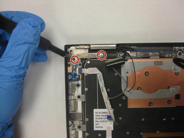

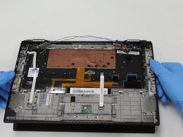

  26. Lenovo Thinkpad X1 Carbon 4th Gen Display Replacement, Display: crwdns2935265:026crwdnd2935265:01crwdnd2935265:02crwdne2935265:0 Lenovo Thinkpad X1 Carbon 4th Gen Display Replacement, Display: crwdns2935265:026crwdnd2935265:02crwdnd2935265:02crwdne2935265:0
    • Notice the location of the screws, as the top outside corner of each side does not get a screw.
    • Using a Phillips #0 screwdriver, remove the four 5 mm silver screws from the display hinges.

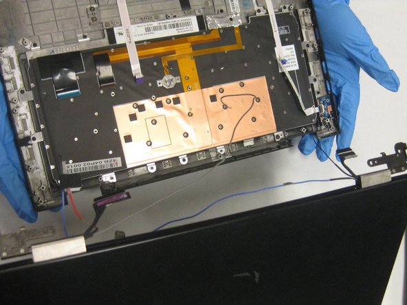

  27. Lenovo Thinkpad X1 Carbon 4th Gen Display Replacement: crwdns2935265:027crwdnd2935265:01crwdnd2935265:03crwdne2935265:0 Lenovo Thinkpad X1 Carbon 4th Gen Display Replacement: crwdns2935265:027crwdnd2935265:02crwdnd2935265:03crwdne2935265:0 Lenovo Thinkpad X1 Carbon 4th Gen Display Replacement: crwdns2935265:027crwdnd2935265:03crwdnd2935265:03crwdne2935265:0
    • Using a Phillips #0 screwdriver, remove the two 2 mm screws securing the wires in place.
    • Gently remove the wires from their tight fit pinch clamps.
    • Gently wiggle the display brackets back and forth until the display is off.

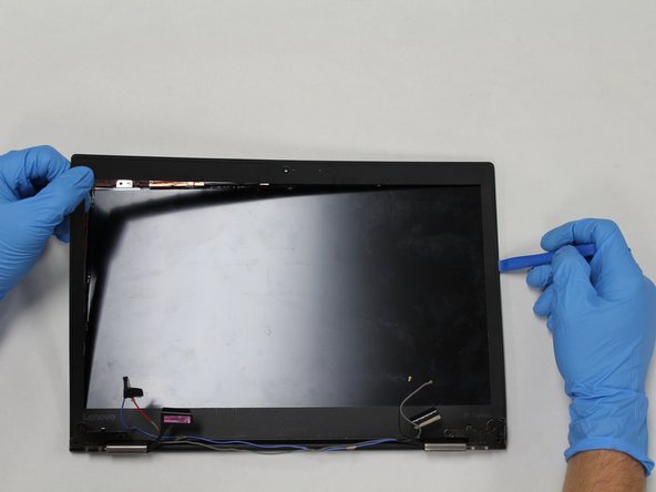

  28. Lenovo Thinkpad X1 Carbon 4th Gen Display Replacement: crwdns2935265:028crwdnd2935265:01crwdnd2935265:03crwdne2935265:0 Lenovo Thinkpad X1 Carbon 4th Gen Display Replacement: crwdns2935265:028crwdnd2935265:02crwdnd2935265:03crwdne2935265:0 Lenovo Thinkpad X1 Carbon 4th Gen Display Replacement: crwdns2935265:028crwdnd2935265:03crwdnd2935265:03crwdne2935265:0
    • Insert the plastic opening tool into the side of the display in between the gaps, separating the bezel from the rest of the display.
  29. Lenovo Thinkpad X1 Carbon 4th Gen Display Replacement: crwdns2935265:029crwdnd2935265:01crwdnd2935265:01crwdne2935265:0

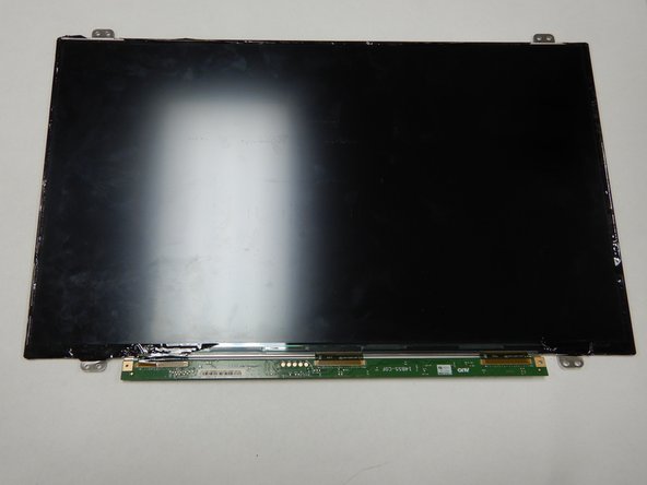

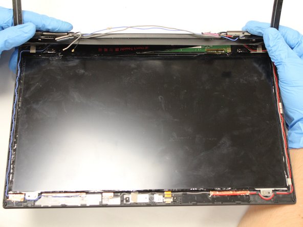

    • Using a Phillips #0 screwdriver, remove the four 2 mm screws securing the display to the cover.
  30. Lenovo Thinkpad X1 Carbon 4th Gen Display Replacement: crwdns2935265:030crwdnd2935265:01crwdnd2935265:02crwdne2935265:0 Lenovo Thinkpad X1 Carbon 4th Gen Display Replacement: crwdns2935265:030crwdnd2935265:02crwdnd2935265:02crwdne2935265:0
    • Lift up on the screen.
    • Disconnect the ribbon cable connecting the circuit board to the display.
    • Do not remove the Do Not Touch Tape.
