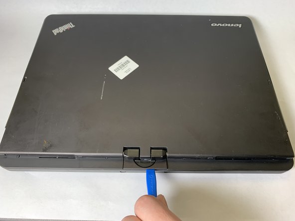

    • Close the lid and turn the device around.
    • Use the iFixit Opening Tool to lift up and remove the tab on the back.

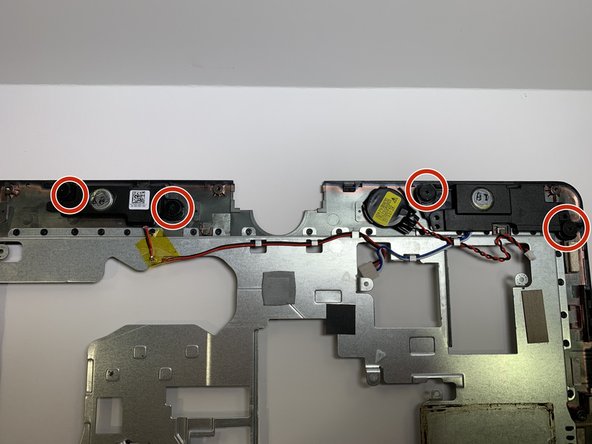

    • Flip the laptop cover over.
    • Using a Phillips #1 Screwdriver, remove the four screws holding the speakers in.
  14. Lenovo Thinkpad Twist s230u Speaker Replacement: crwdns2935265:014crwdnd2935265:01crwdnd2935265:01crwdne2935265:0
    • Remove the speakers from the device.
