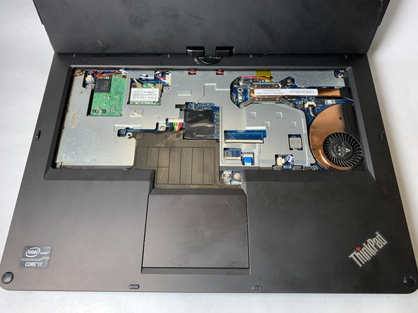

    • Use a Philips #1 screwdriver to remove 2 screws on the bottom of the laptop.
  2. Lenovo Thinkpad Twist s230u Keyboard Replacement: crwdns2935265:02crwdnd2935265:01crwdnd2935265:01crwdne2935265:0
    • Use a spudger to loosen the keyboard around the edges.
    • Carefully push the keyboard towards the screen to unlatch it.
    • Do not push too hard, as there are ribbon cables attached to the keyboard.
  3. Lenovo Thinkpad Twist s230u Keyboard Replacement: crwdns2935265:03crwdnd2935265:01crwdnd2935265:01crwdne2935265:0
    • Carefully lift up the keyboard to access the wires underneath.
    • Be careful not to break the ribbon cables attached underneath.
  4. Lenovo Thinkpad Twist s230u Keyboard Replacement: crwdns2935265:04crwdnd2935265:01crwdnd2935265:03crwdne2935265:0 Lenovo Thinkpad Twist s230u Keyboard Replacement: crwdns2935265:04crwdnd2935265:02crwdnd2935265:03crwdne2935265:0 Lenovo Thinkpad Twist s230u Keyboard Replacement: crwdns2935265:04crwdnd2935265:03crwdnd2935265:03crwdne2935265:0
    • Open the small black flap on each of the ribbon cables. It should lift with a slight effort.
    • Pull out the ribbon cables and remove the keyboard from the device.
