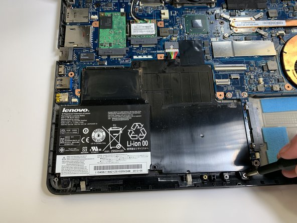

    • Remove the single silver screw using the Phillips #1 screwdriver.
  14. Lenovo Thinkpad Twist s230u Battery Replacement: crwdns2935265:014crwdnd2935265:01crwdnd2935265:01crwdne2935265:0
    • Unplug the colored cables.
  15. Lenovo Thinkpad Twist s230u Battery Replacement: crwdns2935265:015crwdnd2935265:01crwdnd2935265:01crwdne2935265:0
    • Lift the battery out of the laptop.
