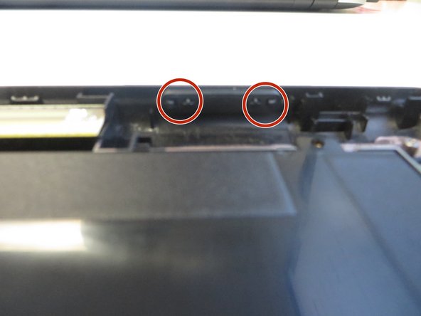

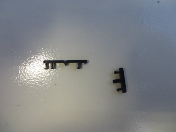

  8. Lenovo Thinkpad Tablet 1838 Button Replacement: crwdns2935265:08crwdnd2935265:01crwdnd2935265:03crwdne2935265:0 Lenovo Thinkpad Tablet 1838 Button Replacement: crwdns2935265:08crwdnd2935265:02crwdnd2935265:03crwdne2935265:0 Lenovo Thinkpad Tablet 1838 Button Replacement: crwdns2935265:08crwdnd2935265:03crwdnd2935265:03crwdne2935265:0
    • To remove the buttons, you need to push the little black tabs towards each other with either your fingernails or plastic spudger.
    • While the tabs are pushed in the buttons should pop out.
