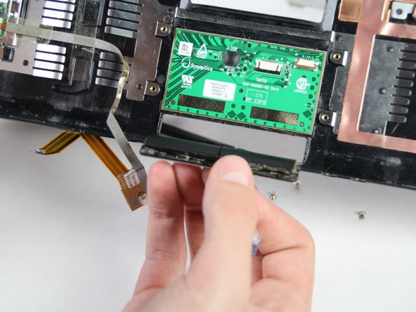

    • Remove the eight 14mm screws using the Phillips #0 Screwdriver.
  2. Lenovo Thinkpad T500 Trackpad Buttons Replacement: crwdns2935265:02crwdnd2935265:01crwdnd2935265:01crwdne2935265:0
    • Lift the palm rest panel up.
    • Be sure to lift the panel slowly; there is a ribbon cable attached to the bottom.
  3. Lenovo Thinkpad T500 Trackpad Buttons Replacement: crwdns2935265:03crwdnd2935265:01crwdnd2935265:01crwdne2935265:0
    • Use the spudger to disconnect the ribbon cable.
  4. Lenovo Thinkpad T500 Trackpad Buttons Replacement: crwdns2935265:04crwdnd2935265:01crwdnd2935265:02crwdne2935265:0 Lenovo Thinkpad T500 Trackpad Buttons Replacement: crwdns2935265:04crwdnd2935265:02crwdnd2935265:02crwdne2935265:0
    • Remove the tape, using the spudger if necessary.
  5. Lenovo Thinkpad T500 Trackpad Buttons Replacement: crwdns2935265:05crwdnd2935265:01crwdnd2935265:02crwdne2935265:0 Lenovo Thinkpad T500 Trackpad Buttons Replacement: crwdns2935265:05crwdnd2935265:02crwdnd2935265:02crwdne2935265:0
    • Disconnect the clear ribbon cable.
  6. Lenovo Thinkpad T500 Trackpad Buttons Replacement: crwdns2935265:06crwdnd2935265:01crwdnd2935265:02crwdne2935265:0 Lenovo Thinkpad T500 Trackpad Buttons Replacement: crwdns2935265:06crwdnd2935265:02crwdnd2935265:02crwdne2935265:0
    • Use the Phillips #0 Screwdriver to remove the screws of the frame around the trackpad circuit board.
  7. Lenovo Thinkpad T500 Trackpad Buttons Replacement: crwdns2935265:07crwdnd2935265:01crwdnd2935265:02crwdne2935265:0 Lenovo Thinkpad T500 Trackpad Buttons Replacement: crwdns2935265:07crwdnd2935265:02crwdnd2935265:02crwdne2935265:0
    • Remove the trackpad buttons.
