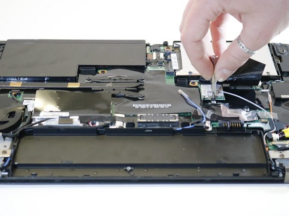

  6. Lenovo Thinkpad T450s Network Adapter Card Replacement, Network Adapter Card: crwdns2935265:06crwdnd2935265:01crwdnd2935265:02crwdne2935265:0 Lenovo Thinkpad T450s Network Adapter Card Replacement, Network Adapter Card: crwdns2935265:06crwdnd2935265:02crwdnd2935265:02crwdne2935265:0
    • Remove the single 3mm screw holding the network adapter in place.
    • You will have to locate and lift up a small, black area of film covering the screw and network adapter.
  7. Lenovo Thinkpad T450s Network Adapter Card Replacement: crwdns2935265:07crwdnd2935265:01crwdnd2935265:01crwdne2935265:0
    • Remove the two cables connected (1 black, 1 grey) from the network adapter.
    • The cables will pop off once the screw is removed.
  8. Lenovo Thinkpad T450s Network Adapter Card Replacement: crwdns2935265:08crwdnd2935265:01crwdnd2935265:01crwdne2935265:0
    • Pull the network adapter out of the device.

You neglected something important in step 1. The t450s has 2 batteries, 1 removable and another built in. To do repair work you MUST first reboot to the bios setup and disable the built-in battery in addition to removing the outboard battery.
Also you neglect to mention that the radio adapter has a dual function, wifi and bluetooth; also the bios has a whitelist of acceptable radio cards and it can be difficult to find a replacement.
Also, the screws holding the bottom casing on are phillips head and are screwed into soft plastic, some of the heads being deeply recessed. A phillips head screwdriver will not seat on the head without at least a bit of pressure, so the last turn or two with the screw almost out cannot take the screw out, instead it’s just forced back into the plastic. And with a deep recess, it’s VERY hard to pull the screw out completely.
