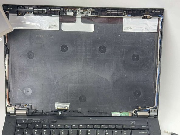

    • Open the computer and remove the screen bezel using a Jimmy to separate the cover clips.
  2. Lenovo Thinkpad T430 Screen Replacement: crwdns2935265:02crwdnd2935265:01crwdnd2935265:01crwdne2935265:0
    • Remove the four screws from the screen using a JIS #00 screwdriver.

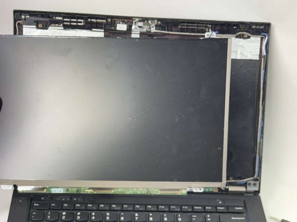

    • Carefully pull the ribbon cable off the back of the screen and remove the screen.
    • Use caution when disconnecting the ribbon cable. It is easy to damage if you are not careful.
