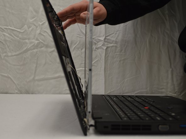

  4. Lenovo Thinkpad Edge E545 Screen Replacement, Screen: crwdns2935265:04crwdnd2935265:01crwdnd2935265:02crwdne2935265:0 Lenovo Thinkpad Edge E545 Screen Replacement, Screen: crwdns2935265:04crwdnd2935265:02crwdnd2935265:02crwdne2935265:0
    • Then, use the end of a spudger to remove the two screw covers from the top and bottom corners of the display.
  5. Lenovo Thinkpad Edge E545 Screen Replacement: crwdns2935265:05crwdnd2935265:01crwdnd2935265:01crwdne2935265:0
    • Slide your finger underneath the plastic and pry gently to release the clips around the display bezel.
  6. Lenovo Thinkpad Edge E545 Screen Replacement: crwdns2935265:06crwdnd2935265:01crwdnd2935265:02crwdne2935265:0 Lenovo Thinkpad Edge E545 Screen Replacement: crwdns2935265:06crwdnd2935265:02crwdnd2935265:02crwdne2935265:0
    • Lastly, peel up the adhesive tape to unbind the metal retaining bracket on the display cable.
